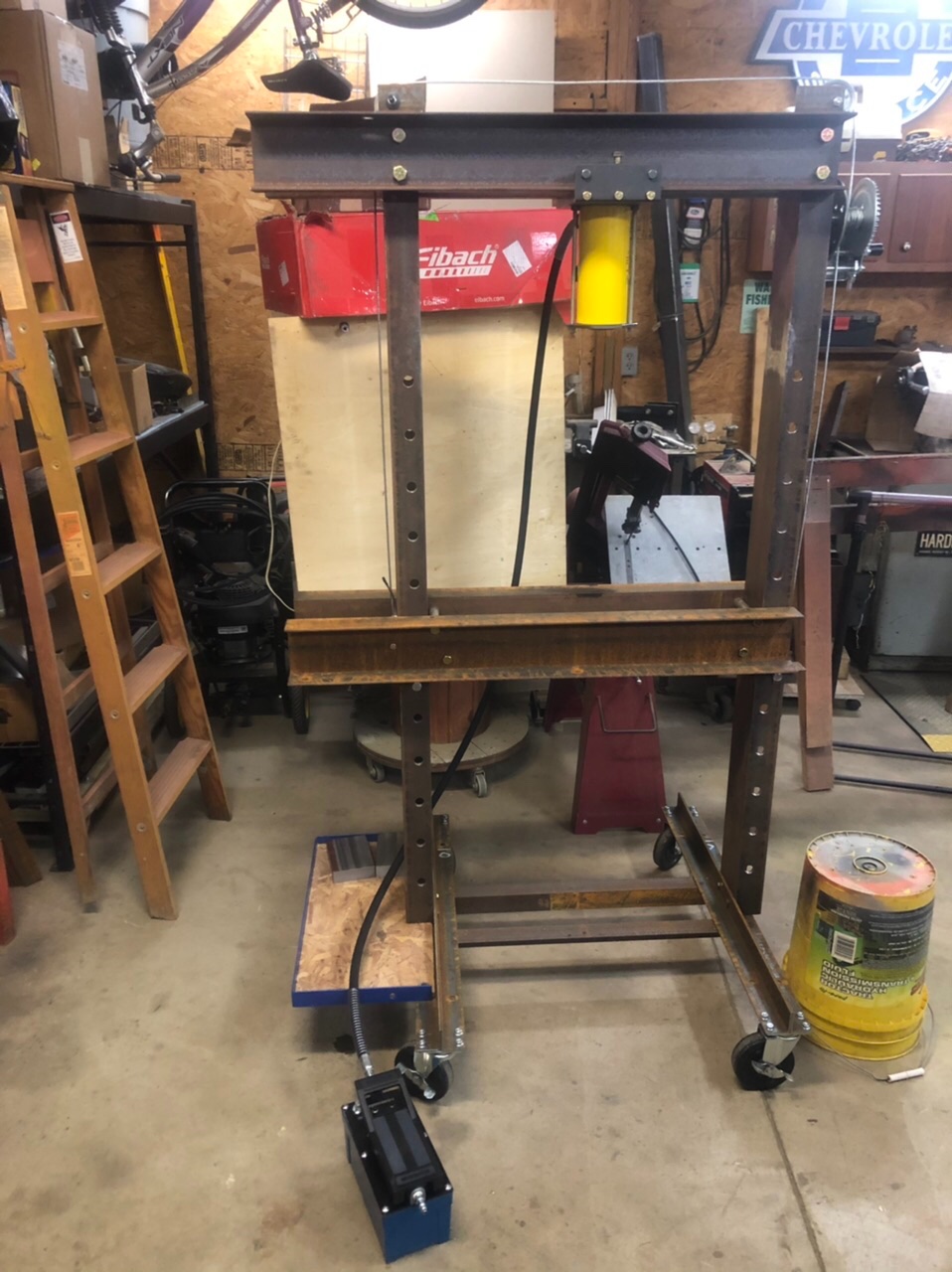

  1. Most of my spare time has been spent in the garage working on various projects. Built an under seat storage box for my truck, a shop clock from a 24” cast iron gear, and I’m finishing up a 20 ton press.

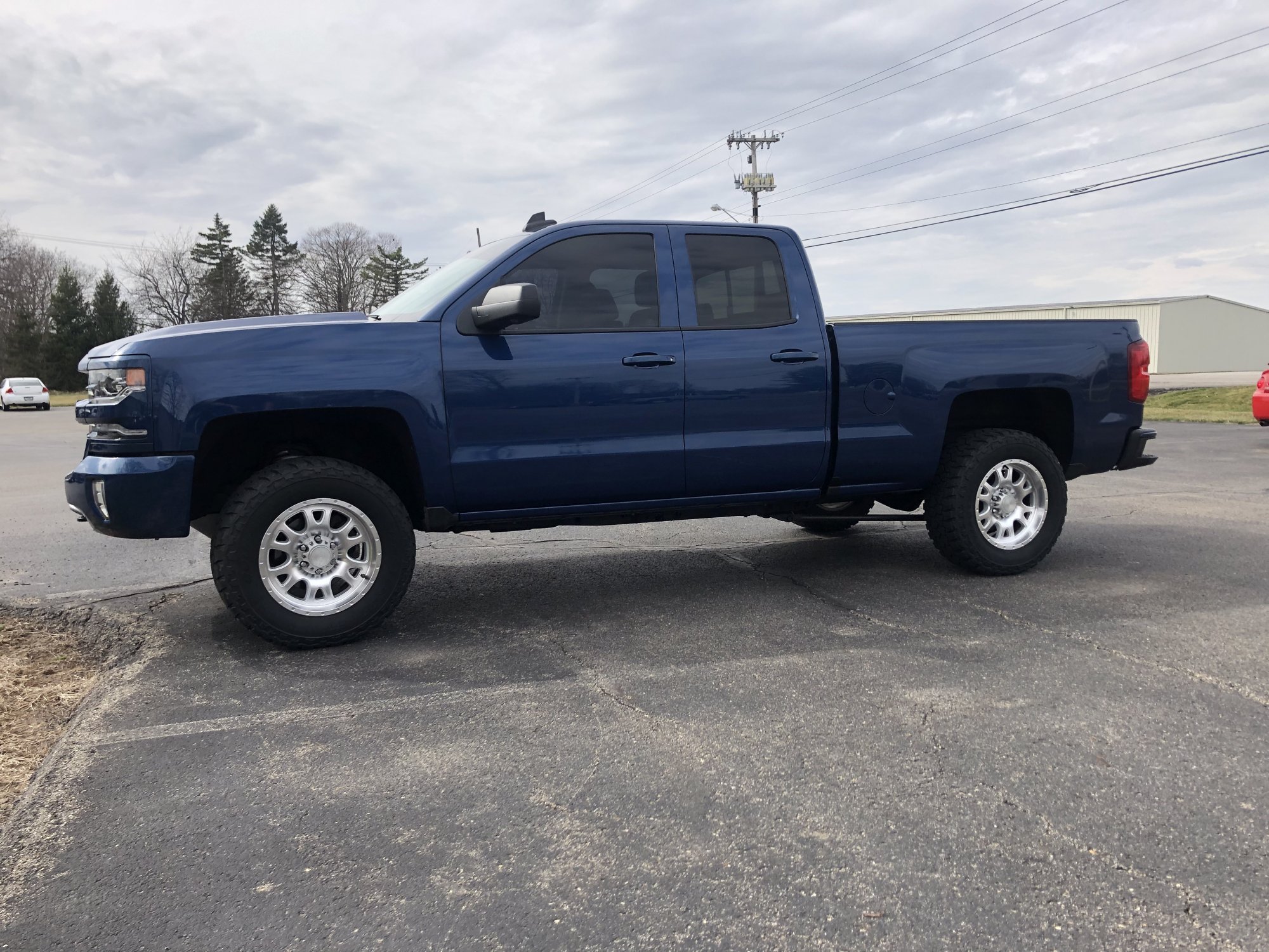

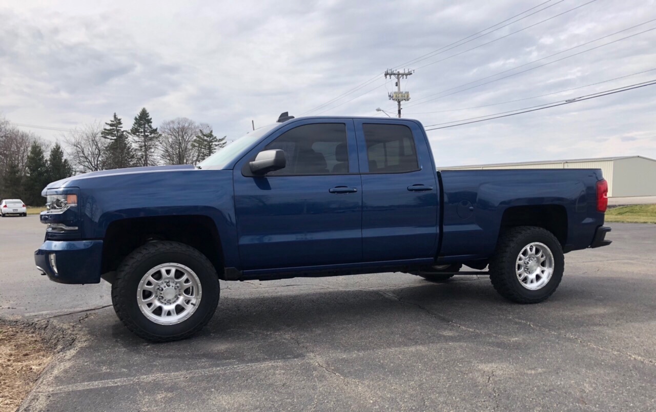

  2. Eibach 2.5” Pro Truck lift, 2” rear blocks replaced factory 1.25” blocks, 285/65/18 on 18x9 with +12 offset. No rubbing at all even when it had 1.75” level before Eibachs.

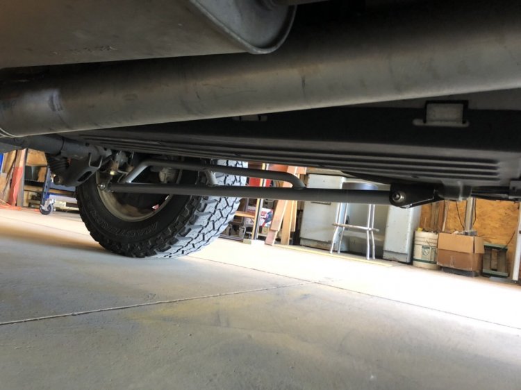

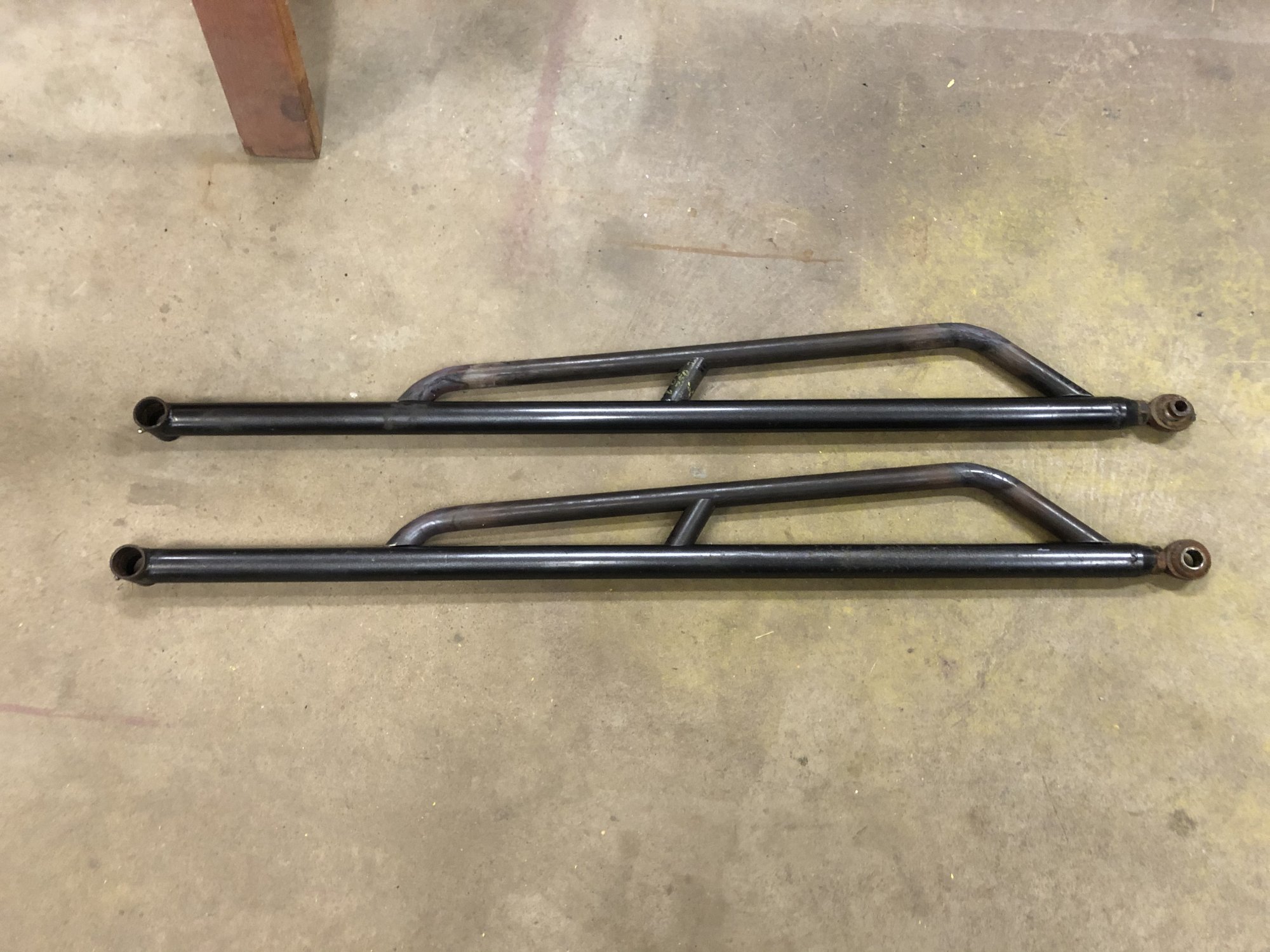

  4. Got the traction bars back on.
  5. Big Sexy! Painted my traction bars today. I’ll get them back on tomorrow.

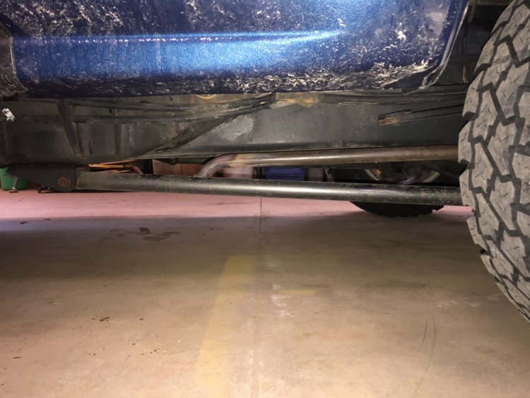

  8. Pulled off my traction bars to add a little style and repaint them.

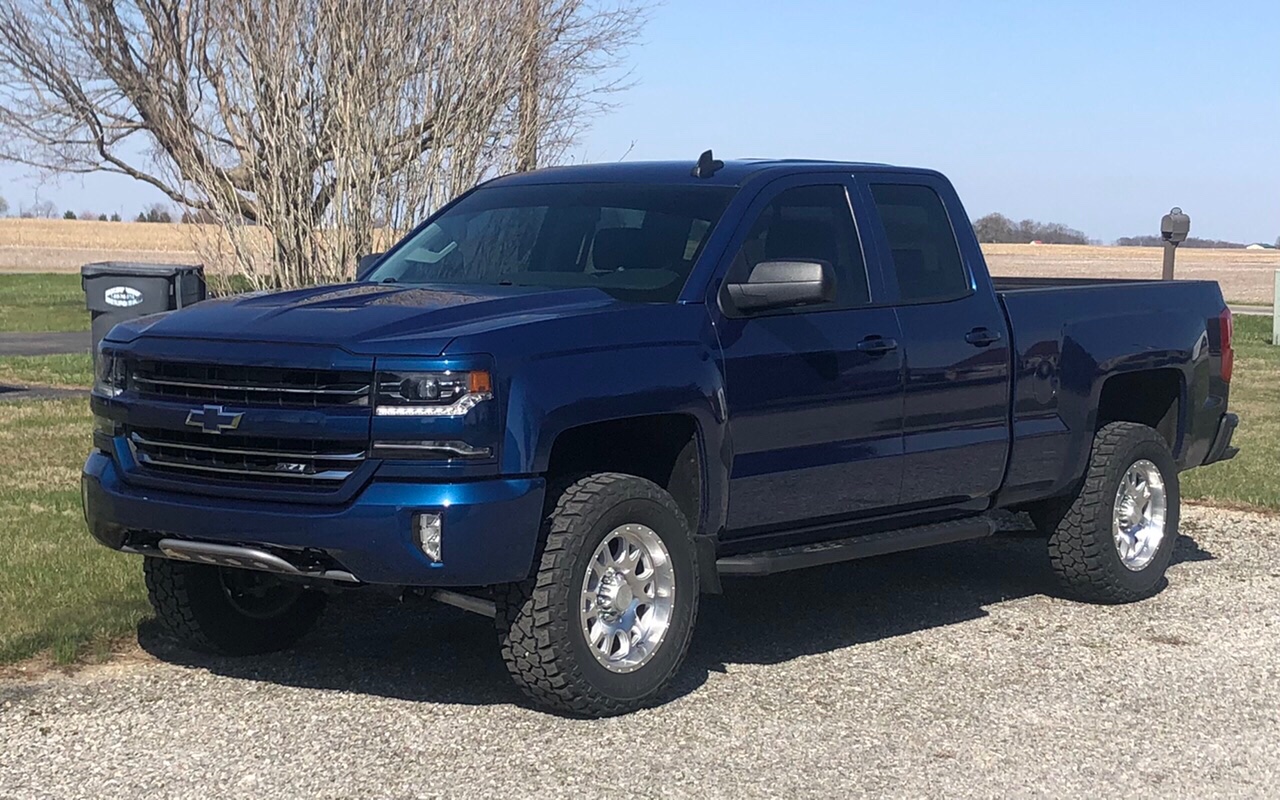

  9. Put the boards back on in the new higher position
  10. You may want to avoid steel steps or boards living in New England. Otherwise, you’ll be dealing with rust issues. I live in the rust belt so I went with DeeZee NXT boards since they’re aluminum. I’ve had them for 4 yrs and they’ve held up great other than some of the coating pealing off on the bottom side and the mounting brackets rusting. They have a similar look to the RB10/RB20 boards but without the cutout slots that would allow snow and slush to get thrown up through from underneath. I recently sectioned the brackets to raise the boards up closer to the rockers.
  11. Tight to the rockers looks better. I also shortened the boards so they stop at the back of the cab.
  12. After 4 yrs of Indiana winters, the bottom of my DeeZee NXT boards are loosing their powder coat. I scraped off the loose coating, wire brushed them, and am going to spray bedliner coating on the bottom and the brackets. I’m also sectioning the brackets 1.25” to raise the boards closer to the rockers.

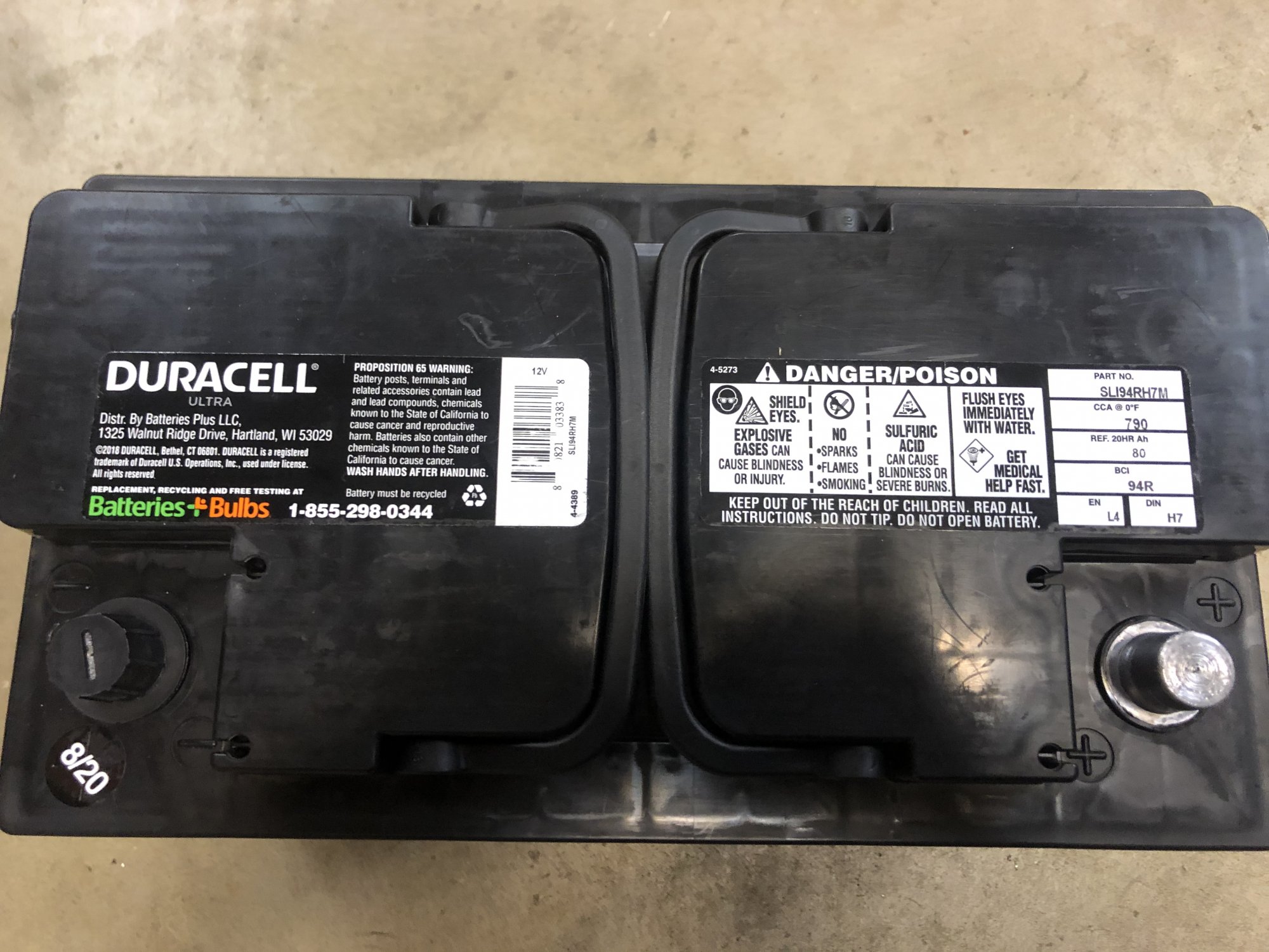

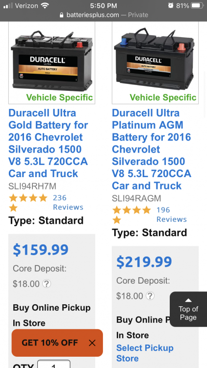

  14. Just looked it up on their site. $160 Site says 720 CCA, my battery says 790 CCA

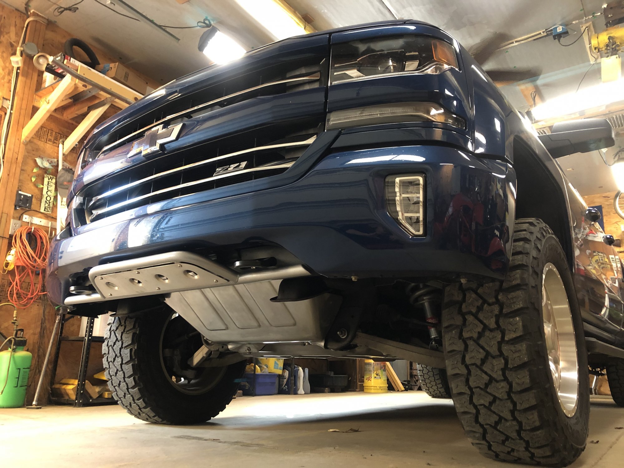

  15. I believe it was around $130-$150

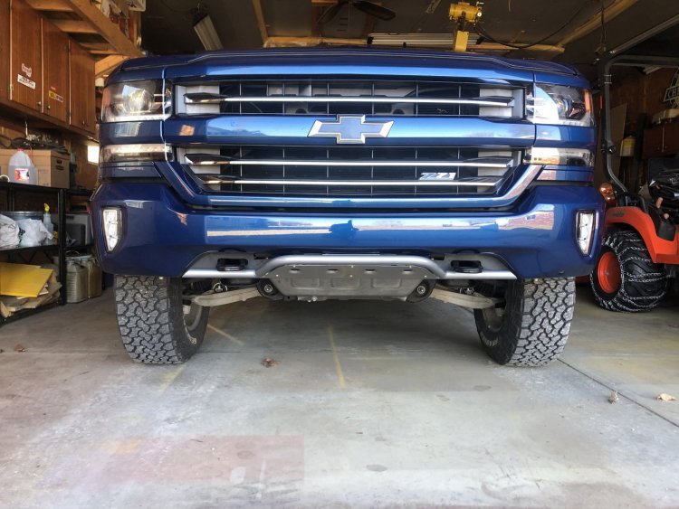

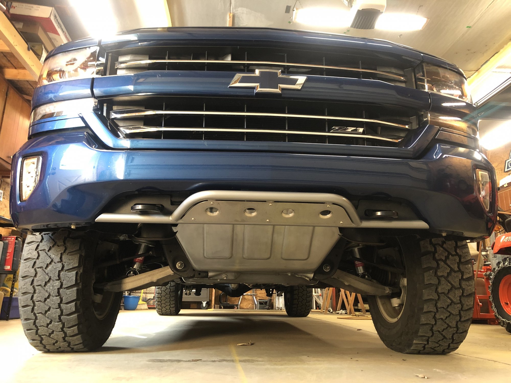

  16. I had to replace the battery in my ‘16 a couple months ago. Went with a Duracell from Batteries Plus Bulbs. From my research, the Duracell batteries are a relabeled Deka.

  20. Ground off the parting line and smoothed my lower control arms on the front side. I’ve been thinking about doing this since I removed the lower bumper plastic.

  23. Sportin’ new Eibach Pro Truck Lift and 2” Motofab rear blocks.
  24. Thanks. To me, it actually looks a little higher in person.
  25. Thanks. I built the skidplate in the center of the bumper with 1-1/4” tubing and a piece of stainless.
