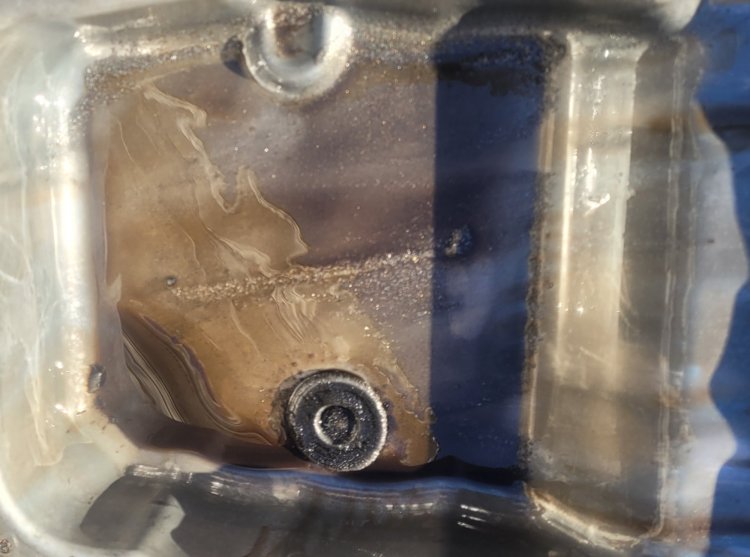

  3. Brief update on this, but I think changing the fluid accelerated my demise. Tried to drive the truck the other day and the trans was slipping pretty bad. Pump was also whining loudly. So now worst case scenario. Anyone have a shop recommendation in Northern Virginia area? Was quoted 7500 by one shop. Terrible timing with the cold weather, but I'm also considering trying to tackle it myself.

  5. Yeah, 6 speed i assume that's with a tech 2 scanner? at full throttle, it seems to shift just fine. it's when i am slowly accelerating that i'll get the hesitation around 28-30mph. i guess a trip to the dealership for a diagnosis is in my future.
  6. Just started getting some hesitation on acceleration and so I was hoping that fresh fluid might fix the issue. But after draining about 7 qts and refilling and new filter, the issue is still there around 30 mph. So back to the drawing board, but I'm thinking it's probably the torque converter.
  7. Well, give it to me straight. 90k miles, original fluid. Should I start donating plasma to pay for a new transmission?
  8. 2016 LT 5.3 with about 90k miles and truck is now starting to show symptoms of this issue I believe. On acceleration, it seems to be hesitating or mis-firing. Original fluid, so I'm going to try and drop the pan and do a filter and fluid change. If I wanted to do multiple drain and fills, how long between each one should I do?
