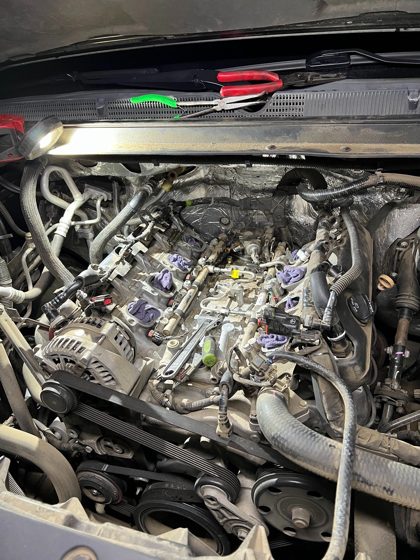

Tonight, we removed the intake, fuel lines, one rail and set of injectors. I ordered new OEM injectors, fuel rails, high pressure fuel line, and injector harnesses since I'd rather not open this thing up again if I can avoid it. Since this is a 2015, there are no small boots and the end of the damn injectors were nearly seized to the head, so I ordered two seal kits from GM also. PB blaster certainly helps to loosen things up, but this job is miserable, especially when it's the wife's car. -

Thanks @steelerdude15 and @rav3 for taking the time to respond. I drove it over to a friend's to hook up to his scanner, and although the check engine light was on, it was fine until it got to temp, then a dead hole, flashing check engine light, and traction control light. Cylinder 2 misfires were incrementing, so sounds electrical. Going to pull the intake and try and locate some injectors tomorrow, inspecting the injector harnesses while it's apart, and cleaning the intake while it's off. I reminded the wife we should've pulled the trigger on that 02 SS camaro I found for my soon-to-be-licensed son. We could've had a backup car other than my 67 in this rain! Thanks again guys. -
Wife drove across town (in the rain) in our 2015 Yukon XL Denali and after getting gas, made it about 1/4 mile, stopped at a light, then began to feel a vibration, and check engine light started flashing. She made it home, I scanned it and came up with the above codes. I fired it up, cleared the codes, then the miss started again. We've got just under 120k on this thing. Are we thinking injector #2? Appreciate any insight!
