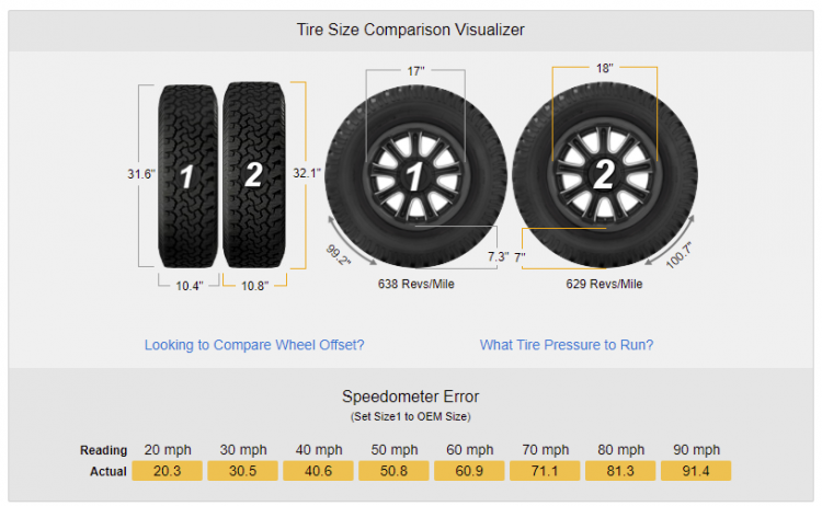

  8. The actual tire size (what it should be) is noted on a label inside the drivers door jam. Assuming your sizes noted are correct, the difference is negligible. See below:
