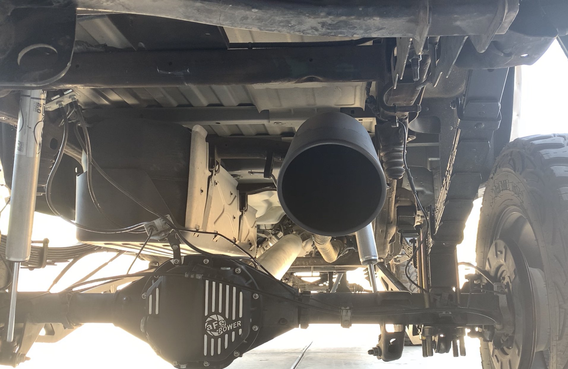

  5. I have the AFE Differential Cover on mine...
