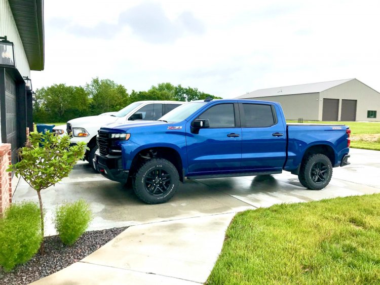

Brink wheels B103 20x9 with BFG K02 285/60/20. Fox coilovers for level. They come with black center caps with the Brink logo, I hated the look so I painted them and put a bowtie decal there. I'm really just MEH on these wheels, might change them up.
