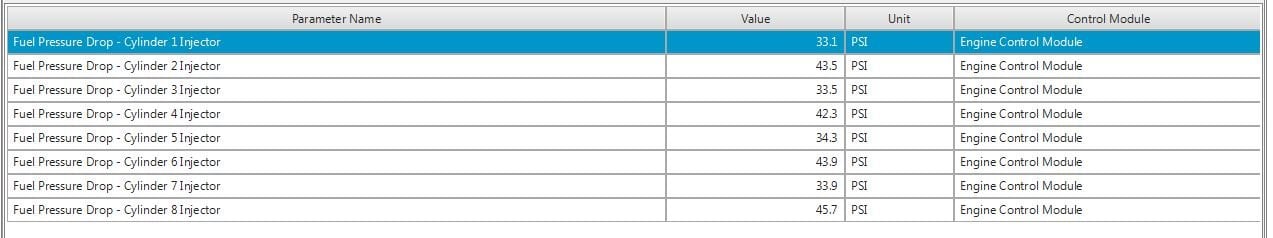

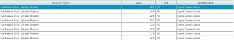

Ok so I wanted to post a little explanation of how I personally test the P050D code to find out if my injectors are bad or not. This also works for High or low fuel trims. So Here is the injector drop on a bad set of injectors in a 2016 Silverado. Here is the same truck after the injectors have been replaced. So brand new injectors. Now. With the new set of injectors if we follow the GM guidelines for testing the injectors. We should add all of Each bank up. So 1,3,5,7 and 2,4,6,8 then multiply it by 0.20 and that's the allowable drop. (1,3,5,7) = 134.8/4 = 33.7 x 0.20 = 6.74 (2,4,5,8) = 175.4/4 = 43.85 x 0.20 = 8.77 So bank 1 each injector should be above 26.96 and below 40.44 And Bank 2 each injector should be above 35.08 and below 52.62 Or if you wanted to add all 8 together you can do 1 drop for the whole vehicle. 310.2/8 = 38.78 x 0.20 = 7.76 So every injector should be between 31.20 and 46.54 The problem I have with this method is bank 1 has farther to go to be over fueling and bank 2 has farther to go to be under fueling. That's why I like to do each rail separately. Now with that being said. I have not run into any over fueling injectors yet. Doesn't mean I won't but I have a pile of under fueling injectors and here is my rule of thumb. If it under 26 on bank 1, I am replacing those injectors. If it is under 36 on bank 2. It is getting those injectors. Following this method has not let me down yet. Here is a video on replacing the fuel injectors as well. I hope this helps everyone, and at least gives you some kind of explanation on the P050D, P0174 and P0175. If you have any questions, send me a message or follow me on Twitter @cdarnau and send me a message there. I will be glad to help you as much as possible.
