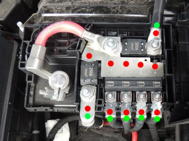

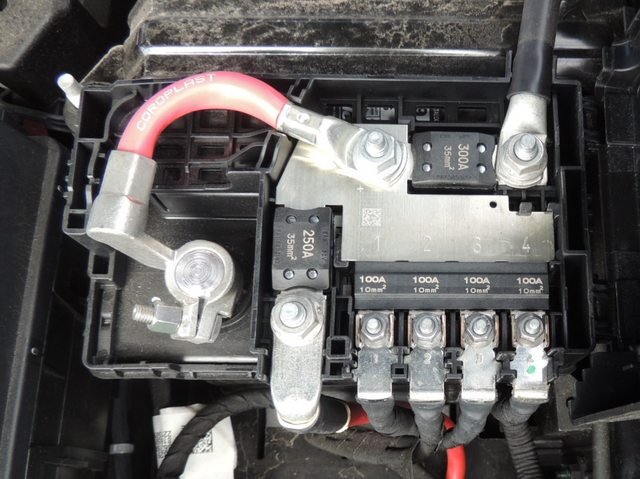

Ok, Is someone going to charge you for this? There is no such thing as a battery reset for the computer. Trust me, I know. I have put in 1000 batteries in these trucks and never ever have had to do this. I also work at a GM dealership with a mass of other techs who also replace these batteries never having to do this. Let's start by doing this. Who installed the battery? 9 times out of 10 if someone else installs your battery other than a tech you will have this issue. On top of the battery itself is a Battery block. A lot of times things either get left loose here or the metal bracket gets cracked during removal. This is a very thin piece of metal that transfer the power. Below is a picture of the Battery Block. The next picture has colors on it and I want you to check this the way I explain. First, The green circles on the image. I want you to gently wiggle these wires and see is they are loose. Also take an 8mm Socket and tighten them up just to make sure they are tight. A lot of times these will be left loose and are not seated correctly. Make sure they are in the right order too. You will see numbers on them. Number 1 cable should go to number 1 on the block ect. After all these have been checked and made sure they were tightened correctly. Goto this step if you have not found the problem. Take a test light (a cheap test light with a cheap bulb is the best. So don't spend a lot of money if you don't have one. Buy the least expensive one that's NOT an LED test light. You do not want an LED) and test all the red spots on the picture to the ground. So connect one side of the test light to the ground post and touch the red spots with the other and make sure they all light the test light up FULLY. If one is not as bright as the others, make sure to let me know. They should all light the test light up bright. Let me know what you find when you have checked this. -
