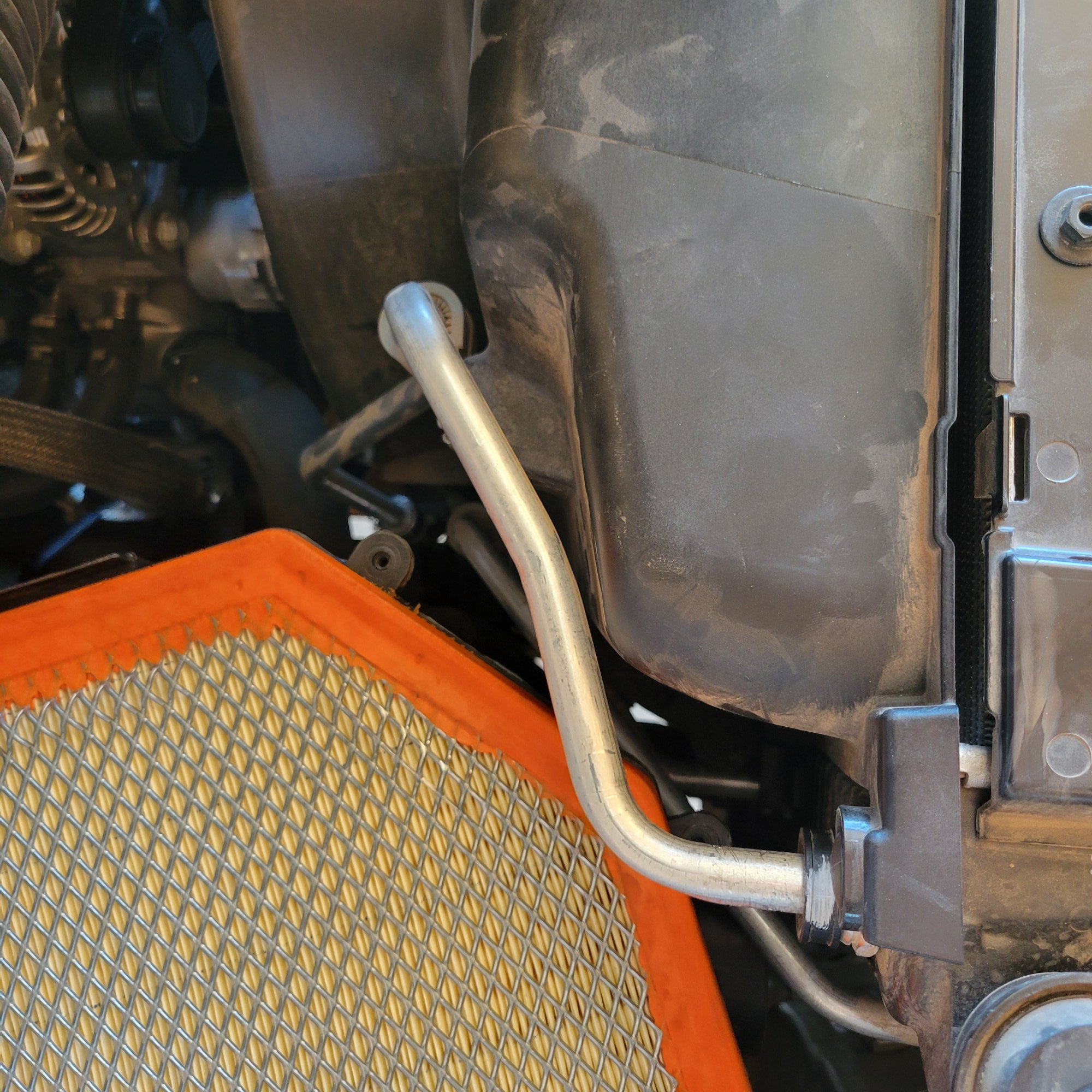

  22. There's a small chance the Banks would work. It looks like it dives down right where the oil line would be. I'd need a closer picture, especially from a horizontal angle if anyone has one. If the point of that box sits lower than where the line would be, we could have an option. Additionally, the Banks would be easer to adapt to the L8T throttle body since it has a short fixed pipe and goes right to flexible bellows. Would be a decent mod to have that box and get rid of the stock Helmholtz resonator in the process.

  24. I am the farthest along with the swap. I have 100% of the parts and 95% of them installed. The problem with the diesel hood intake on the gas is an oil cooler line that conflicts with where the diesel airbox is. The diesel airbox is longer and protrudes into the area where this hard oil cooler line terminates into the radiator. Short of doing some type of plastic welding wizardry to the air lid, to proceed the "easiest" (lol) way is to convert that hard oil line into a flexible AN line or buy some tubing and bend one yourself. I am not familiar with GMs connection style at the radiator. Looks like it plugs into the fitting and uses a copper snap ring to hold it in place and has a plastic cover that slips over. Something tells me there is a chance there is a way to adapt to this and route the oil line away but I've taken a long break from this project and am barely scratching at it once in a while when time permits (it doesn't). Even so, it would need such a hard bend to clear the box that it still probably wouldn't work. A 90' AN fitting probably also sticks out farther than the stock line. What you see below is the diesel lower box and filter fully installed. Note where the lid would sit and seal and the forward most screw hole directly under the line. No bueno. The easier option than even this might just be running an aftermarket external oil cooler with custom AN braided lines. There are block adapters sold that would work. What we really need is the designed and never released gas air box for the diesel hood intake. Not going to happen. Nor will an aftermarket solution come to the rescue. S&B and Banks diesel are also probably just as long as the stock box and would hit the line and also they use a hard upper discharge pipe to the differently placed TB location instead of the flexible stock one so again, no bueno. Sucks to be so close and fail but thems the breaks.
