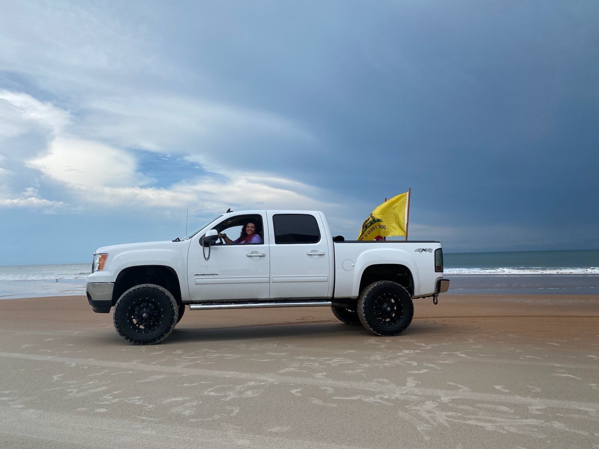

  20. This is my daughter's NHT Sierra with 3.73s and the 6.2 motor. It's been running the lift and tires for ten years now without issue and can pull a house down still. She hauls hay with it sometimes and it effortlessly pulls trucks out of the mud when they're out playing in the woods or on the beach. The taller tires (35s) have reduced the axle ratio to being akin to 3.42s. Someday we'll regear it to 4.10s so the gearing will be more or less back to stock 3.73s with the 35s. We talk about going to 4.56s which would be akin to 4.10s but if she goes to 33 inch tires or removes the lift than that would be an additional expense.
  21. The truck you chose was set up for highway cruising, not towing it seems. Then you made it worse with the lift and 35s. Regear for 3.73s and have it tuned to match and you won't miss that Ferd.
