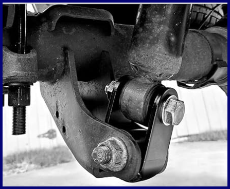

Do rear shock extenders create a pivot point?
17Sierra1500 replied to 17Sierra1500's topic in Modifications & Accessories
Thanks for the replies! I ended up buying a RC "Denali / Magnaride" rear shock kit 188BOX9. It was designed to be used on as 5" lift with the OEM rear magnaride shocks. Luckily, this kit has shock extensions with an additional anchor point, as to not allow the extension bracket to pivot. Working good. -
