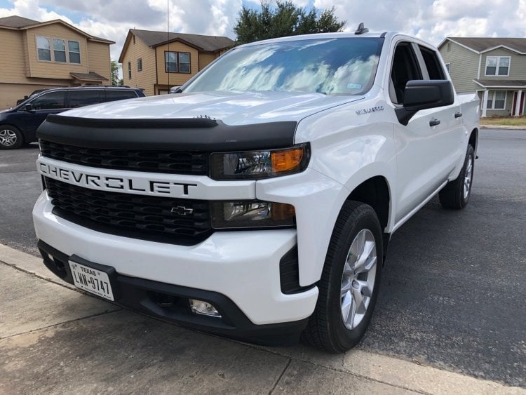

You can definitely tell the difference in added wind noise. It can be taken off completely without opening the hood - tt's attached with the same material that the truck badges/decals are affixed with so there's no quick removing it. They provide you with alcohol wipes -- maybe it'll help with the ceramic coating? And thanks! -

3M Tape it’s very secure and doesn’t give at all. -

I got mine from the Chevy Accessories website. Took this picture when I swapped out my bow tie emblem to the black one. You can see the old one by the hood deflector so don’t think those little spikes are part of the molding. But I love mine! Looks awesome. ? Aeroskin II® Hood Protector in Textured Black by LUND® - Associated Accessories Part No.: 19417399 MSRP: $109.00 | Quantity: 1 | Delivery Method: Pickup at Dealer - No Additional cost https://accessories.chevrolet.com/product/aeroskin-ii-hood-protector-in-textured-black-by-lund-associated-accessories-19417399?year=2019&make=Chevrolet&model=Silverado 1500 -
