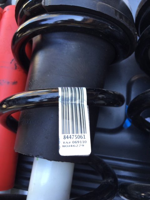

Thanks - did not see those two tags when i looked last night in dark. Mine was 7/20 build - is a late 2020. So right in the middle of the time frame - 3,000 miles so far - no issues - goes into dealer tomorrow for fluid service -

Interested in figuring out the build date on my truck - anyone able to direct me to source for that. Traded my 2019 AT4 for a 2020 to get trailer tow mirrors - in August 2020. So far have 3,000 miles - no issues - but would be interested to know if it was built before the June date. Would hate to get stranded towing with the Family. Also in reading through thread seems like a lot of failures within a few hundred miles of new - any failures with higher mileage trucks? -

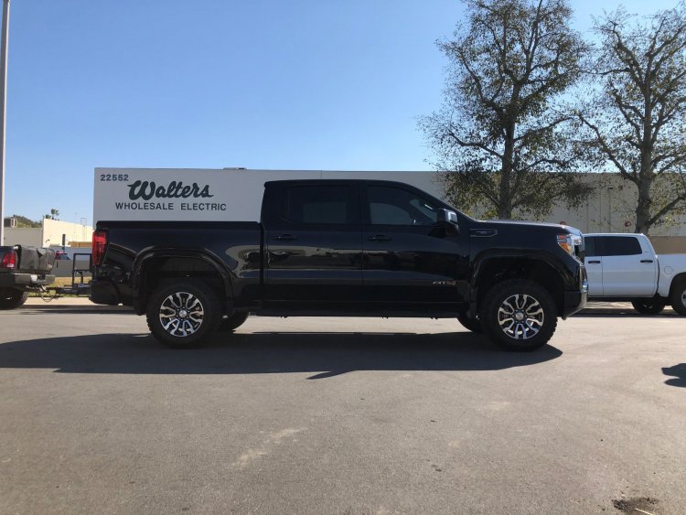

Below is a photo of my 2019 AT4 with 2" Ready Lift SST level kit - so 4" over a stock truck. Note CV angles are pretty extreme for level ground. Also note that RL has on their website a note that states - they don't recomment you use auto 4WD with this kit as they have customers who did and toasted the front diff due to torque of shift on the fly and poor geometry. There are potential issues for your front diff with any level over 2" and common knowledge with experience shops that over 3.5" you will likley have problems sometime down the road - I went 11k on my 2019 with no ill effects, but never used auto 4WD. Losing a feature on your truck like that is not ideal. If you go with a proper lift kit that drops the front diff, you can go 4" or 6" no problem - see photo #2 of my 2020 AT4 (traded to get trailer tow mirros and good camera stuff for towing). This is a BDS lift kit of 2.5" - so on an AT4 that is 4.5" over a stock truck - note the axels are pretty much level - which is what you want. You can get proper lift kit from rough country, zone (owned by BDS but a bit less expensive) or BDS without shocks and you will spend about twice as much as a level kit - but you will not have any issues down the road. 2019 AT4 - note angle of CV axel boots 2020 AT4 - BDS 2.5" Lift Kit -

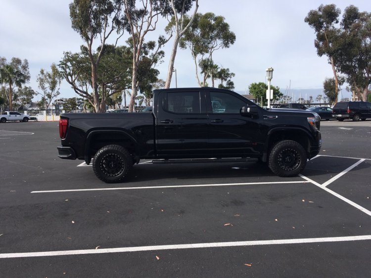

Yes that is the lift I went with - not too extreme, still good for towing and everyday use. Note the large front skid plate that has BDS cut out, was not installed on my truck. The shop that installed stated they have to remove the airdam under the bumper to install and found that it created a large amount of air noise that customers complained about, so they did not recommend putting it on, unless doing a ton of offroad stuff. So I left it off on mine. Here are a few photos
'Yes - any level kit will cause this type of axel angle. Only proper lift kits with diff drop brackets will give you level CV's like the BDS I put in.

I would say 1.5" (3.5" overall) is max, anything over that should have a proper lift kit. Here is a photo of my 2019 AT4 with 2" level kit (so 4" overall) and you can see the angles are pretty extreme. The mfg. - Ready Lift, recommended that you "not" use 4wd auto due to angles potentially causing front diff damage. Below that is my 2020 AT4 with 2.5" BDS lift kit, with diff drop brackets, - you can see the CV's are dead level. For me I would say even if you don't upgrade your shocks, get a 2" proper lift kit to level the truck - will cost more, but long term you will never suffer front failure due to CV Angles. Happy Thanksgiving! 2019 Ready Lift SST 2" level kit with UCA 2020 With BDS 2.5" lift kit

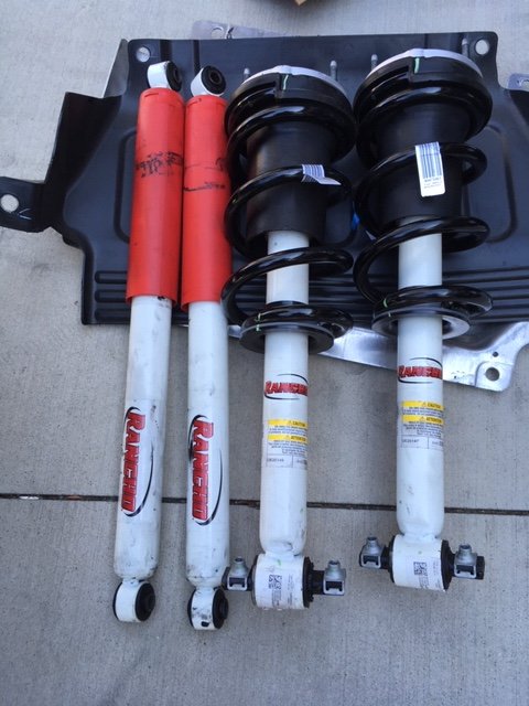

I have 2020 AT4 - took off the Rancho Shock and other related products to install BDS 2.5" lift with Fox Coilovers. If anyone is intersted I am selling the take off parts and skid plates as a package for $500 for S. Cal Local Pick Only - so no time to figure out shipping for something large or heavy. I am in Orange County and am frequently in San Diego for anyone intereted. Shocks, springs (front), steering knucles, rear blocks, two front skid plates, rear block U brackets and bolts Parts taken off at 1,574 mies from new. I also have OEM 18" wheels - they have 20 miles on them - taken off when new as well. Link to ad: I PM me if interested. Thx

Here is a photo of my 2019 AT4 Carbon Pro - with Ready Lift 2" level and UCA's - with stock 275/65/18 dura trac - then a photo of my 2020 AT4 Carbon Pro (traded for tow mirrors and camera tech for trailer) with BDS 2.5" lift kit. You will note pretty extreme angles for the 2" level - but dead level axel for the BDS lift - with diff drop bracket as part of kit. Level's on AT4 and Trail Boss are going to max your CV angles - it works - but may not be the best outcome long term. For the cost and look, it is the way to go. But if you can afford the True, BDS, RC "lift kits" that give you 2.5" lift and drop your diff - you will have best of both worlds - it is more cost - but if you don't go with coilover shocks the cost difference is about double a level kit. 2019 AT4 with Ready Lift SST 2" level kit 2020 AT4 wtih BDS 2.5" lift kit -
Here is the issue - you start with 2" of OEM lift - you add 2" level kit with RL SST kit. It is a nice kit - had it on my 2019 GMC AT4 Carbon Pro. They have a note in there than you "should not use auto 4wd" with the level - issue is the angle of the CV axels is pretty extreme and they had some customers with issues with auto 4wd shifting in and out at various speeds and putting heavy load on front diff due to angles of axels and cv's. I ran my 2019 for10k miles with it, had no issues, but never used auto 4wd. Not ideal, but as good as any other level. When you call knowledgeable offroad shops it is common knowledge (to them) that anything over 4" of lift really needs a drop bracket for the front diff. So level kits on AT4 and Trial Boss are at that edge. I swapped my 2019 for a 2020 with trailer tow mirrors and better camera tech for trailering. I decided to do it right and went with BDS lift kit, which lowers the front diff - so the axels are dead level. I posted some photos below so you can see the difference in angles for yourself. BDS and Zone (who is owned by BDS, but their lower cost brand) offer a 2.5" lift kit for AT4/Trail Boss (so 4.5" of total lift) that lowers the front diff without coilover shocks - other do as well- it is more expensive way to go than RL( RL SST kit can be purchased from Tire Rack for $507 - Zone lift kit no shocks is $1,313), but install is a about the same, but given the better axel angles and no issues with auto 4wd this may be the best way to go. I was able to step up the adjustable coilovers and it was expensive, but well worth the dollars - works great on and off road. link: https://zoneoffroad.com/search?fitment=1 Link: https://bds-suspension.com/product?ma=5&mo=1&ty=113&yr=2019-2021&kid=754F Good luck finding good solution for you. If you do a search there are a number of threads on this topic and lots of photos. READY LIFT - CV AXEL ANGLES - 2019 AT4 - SST KIT - STOCK 275/65/18 DURATRAC TIRES 2020 GMC AT4 - BDS COIL OVER 2.5" (4.5" OVERALL) LIFT KIT AXEL - DEAD LEVEL WHEEL QUESTION - DON'T KNOW ABOUT 20'S BUT FOR REF - THIS IS 275/65/18 ON METHOD NV 18X9 W 18MM OFFSET - ONLY ABOUT 5/8'S OF AN INCH CLEARANCE TO UCA

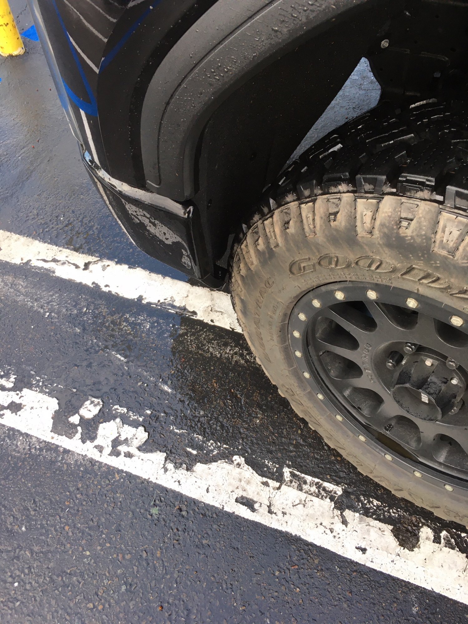

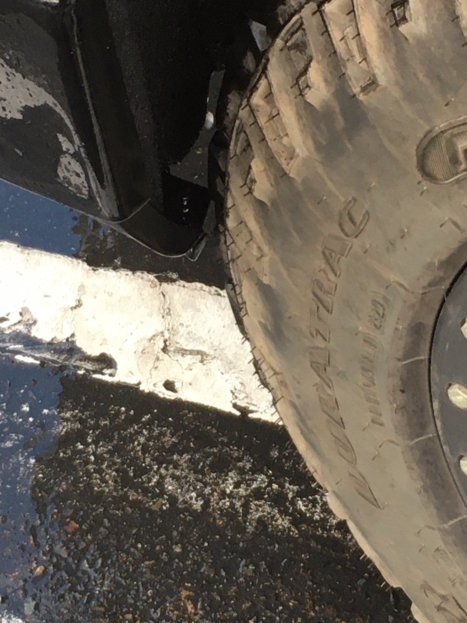

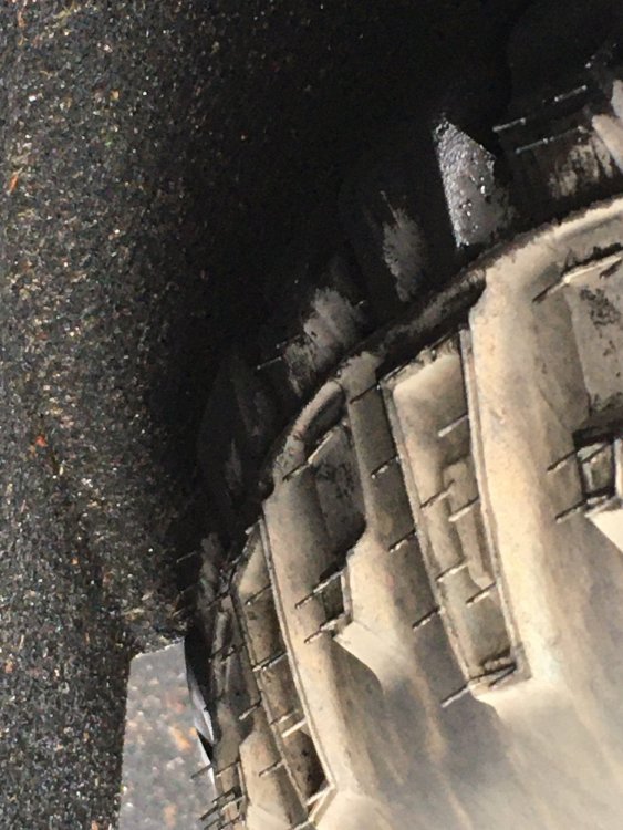

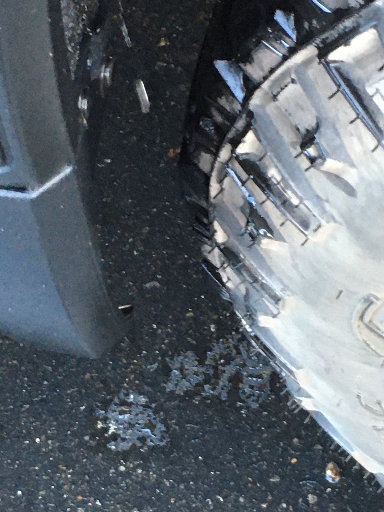

Last Few first one - front 2/3 turn second one - rear of tire full lock last one - front of tire - 2/3 lock - closest pinch point - will rub over - larger tires would need this area trimmed. -

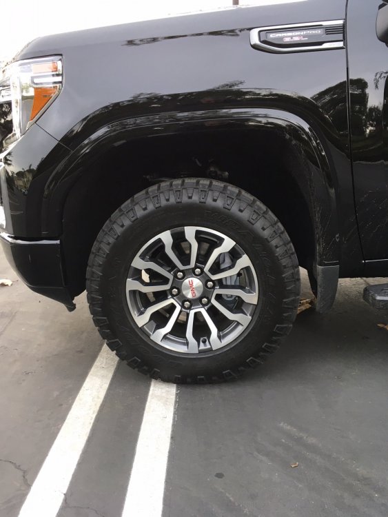

A few more first - front of tire 2/3 turn second - front of tire full lock third - front of tire full lock fourth - front of tire full lock - just barely misses wheel liner -

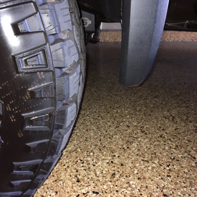

Here are a few more photos of tire clearance - with stock 275/65/18 Duratrac's on Method 18 x 9 wheels with 18mm offset - 2.5" BDS Coilover lift on 2020 AT4. first one - front tire - front clearance - straight wheel - looking inside out. Second one - front clearance - straight wheel - back of tire third - front clearance - straight sheel - front of tire fourth - front clearance - 2/3rd turn of wheel - front of tire fifth - same as fourth - view further away -

I have a 2020 GMC AT4 - I installed 2.5" BDS coilover lift (so 4.5" overall)- it will work with stock 20" wheels - but not likely with stock 18". the AT4 18" is 26mm offset (5.75" of backspacing +/-) - so the tie rod from the BDS lift hits the edge of the wheel and tire, so you have to push the wheel out. I have Method 18x9 NV wheels with 18 mm offset (so about 1/2" more inside clearance - 5.25" of backspacing than stock). I tried a 1.25" extension - did not clear - so we ended up doing wheel lug extensions and getting enough bite on lugs to make it work, but I would not consider it ideal. You need an 18" wheel with 4.5" of backspacing. On the 20" wheel the added diameter allows for the tie rod to be "inside" the radius of the wheel, so you can run stock 20's or other 20's with up to 5.5" of back spacing. I would confirm the offset of your stock Trail Boss wheels - if 26mm like the GMC AT4, you will have a tough time making it work without new wheels. I can tell you that the suspension performs very well on road and is night and day difference off road. If you go that route be sure and get the DSC upgrade so you can adjust compression and rebound to your driving conditions! Here is a few threads about it with photos and showing you clearance issues. Note I had a 2019 AT4 with Ready Lift SST kit before and the CV angles were really bad - with BDS, it is dead level. I would definately go that route, even if you just buy the lift initially and add shocks later, to get the level axels. Link: Link: -
Tough question to answer - the OEM mono tube Rancho's actually ride pretty good on the street. They are way too soft for off road blowing through the stroke very quickly and bottoming out. But overall I found the OEM ride quality to be very good on the street. The Fox/BDS set up is more flexible with DSC adjustments on front shocks for compression and rebound - at full soft or a few clicks odd the ride is excellent, however it is "firmer" than stock. I would consider it comfortable, but if you don't like a firm ride, you would think the stock truck was smoother on the street. Off road, no comparison with the better shocks and lots of adjustments you can really dial in the shocks and enjoy the truck. If you like the stock ride - you may think this is too firm - if you don't like the soft stock ride, then this offers the best of all worlds with total dial in flexibility - on the street I run 2 clicks from full soft on compression and rebound right now. Will try softer after some more miles on the shocks and springs for full break in. Overall it meets my needs and expectations and I am glad I did it. I like this set up much better than the Ready Lift SST kit, with stock shocks I had on my 2019. It is not for everybody, but if you are familiar with adj. off road shocks you will be pleased.
I have a 2020 AT4 Carbon Pro - I did the 2.5" lift (so 4.5" overall) with fox 2.5 coilovers - I have Method 18 x 9" NV's with 18mm offset - they did not clear the tie rod, so we had to go with spacer and wheel lug extender to gain about 1.25" of backspacing, so clear the tie rod. The method -12mm would be the recommended fit. With 20" the tie rod will go inside the wheel radius, making that more flexible for offsets. With 17" you will have the same issue I had, but not as bad due to 0 mm offset - might barely fit, but if not with a 1/2" spacer you should be good to go on the tie rod issue. But you will need to do some trimming to fit the 35's. Pinch point will be the front fender where it tapers in - you only have 2" - going with 35" over stock 33's should eat all that up. I will be very interested to see how yours turns out, as I am looking to get new wheels and larger tires - so if you fit 35's will be interesting to see what all is invovled. I still have stock 275/65/18 duratracs on mine. Here are some photos showing clearance - FYI - no issue on inside clearance on steering knuckle for tire - 4" of inboard room at least - so 12.5" section width will be no problem over stock 11".

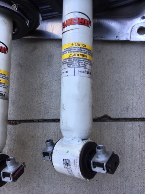

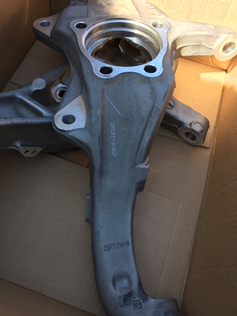

Hi, OEM 18" AT4 Wheels I have four (4) OEM GMC AT4 OEM wheels for sale - no tires - taken off the truck at 50 miles +/- - new condition. $1,250 for all four - only selling as complete set - local sale only (Southern California) Suspension: I have OEM knuckles, front Rancho shocks and springs, rear Rancho shocks and lift blocks and skid plates off 2020 AT4 (replaced with BDS lift). Taken off truck at 1,582 miles. $550 - sell as a package only - local sale only (Southern California). - see link to ad on Craigslist, it has lots of photos Link to Craigslist ad for shocks: https://orangecounty.craigslist.org/pts/d/san-juan-capistrano-2020-gmc-sierra-at4/7216378026.html $225 - Chrome Exhaust tips - off 2019 GMC AT4 (swapped out for the black ones). I traded the 2019 in for a 2020 with trailer mirrors (why I have parts for two different years). Can ship these, buyer pays shipping. Reasonable offers considered. Entire bundles for $1,500. email me at [email protected] and I will respond.
