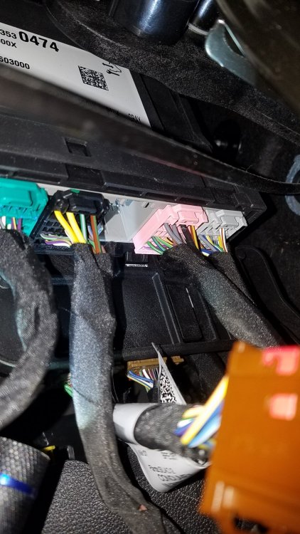

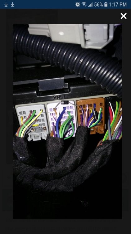

  5. I really dont known what pin # they are. In the above pic it is in the top ledt corner of the brown plug jumped over to top row second from the left of the pink plug.

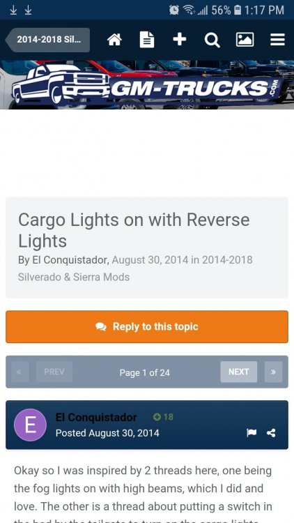

  6. Im all new to this. I was looking at my plug wrong I didn't know that the 1st pic above was the plug with no wires. Looking for better pics of where to place the diode I came across an older post on the fourm from 2014 I believe posted by El Conqistador. Plug the diode in and then the cargo lights come on when you put it in reverse. I hope this helps.

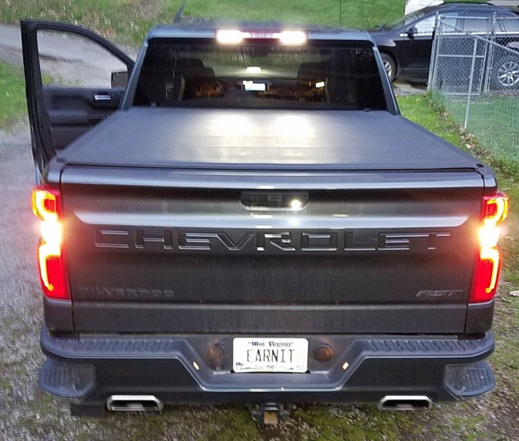

  7. I finally figured it out after some research. I also did the diode mod for the cargo light on with the reverse lights. I like it.
