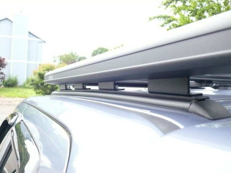

This is the latest thread on this topic I could find and wanted to share my setup that I recently completed. I have an ARE Z Series shell that had the original optional tracks. Since I very much dislike how distant the platforms are from the roof in typical applications using standard mounting brackets and hardware, I decided to custom make the platform mounts. I got a Yakima LockNLoad 55"x49" platform and used 6061 aluminum angles to secure the platform to the tracks. This part was more or less easy, and the setup is very solid. The front was much more challenging since (1) there are no tracks nor factory options for tracks, and (2) the roofline is not straight neither length-wise nor sideways. As a first step, I mounted Thule universal tracks with rivet nuts. I've had such a setup on another car for years and I believe that leaks are not an issue when installation is performed properly. I used construction-grade polyurethane sealant around the rivet nuts during installation. Then, I measured the angle of the tracks and found that I needed an angle of 84 degrees (tightening the setup with 90 degree angles would have caused something to crack, for sure later if not earlier). I had a local machine shop bend about 32" of 5052 1/8" aluminum to exactly 84 degrees (6061 is not good for bending). I cut the piece into 8 pieces and after a lot of adjustments, got the front platform to sit flush with the rear. It was very much non-trivial for a single person to handle (the Yakima platform is quite heavy), but I am very happy with the results. I want to emphasize that I intentionally positioned the platforms close to the roof because of (in my opinion) enhanced aesthetics. This particular Yakima platform does not bend at all with me standing on the roof (~180lbs). I also have a RhinoRack ladder that easily hooks up on the platform for easy loading/unloading.

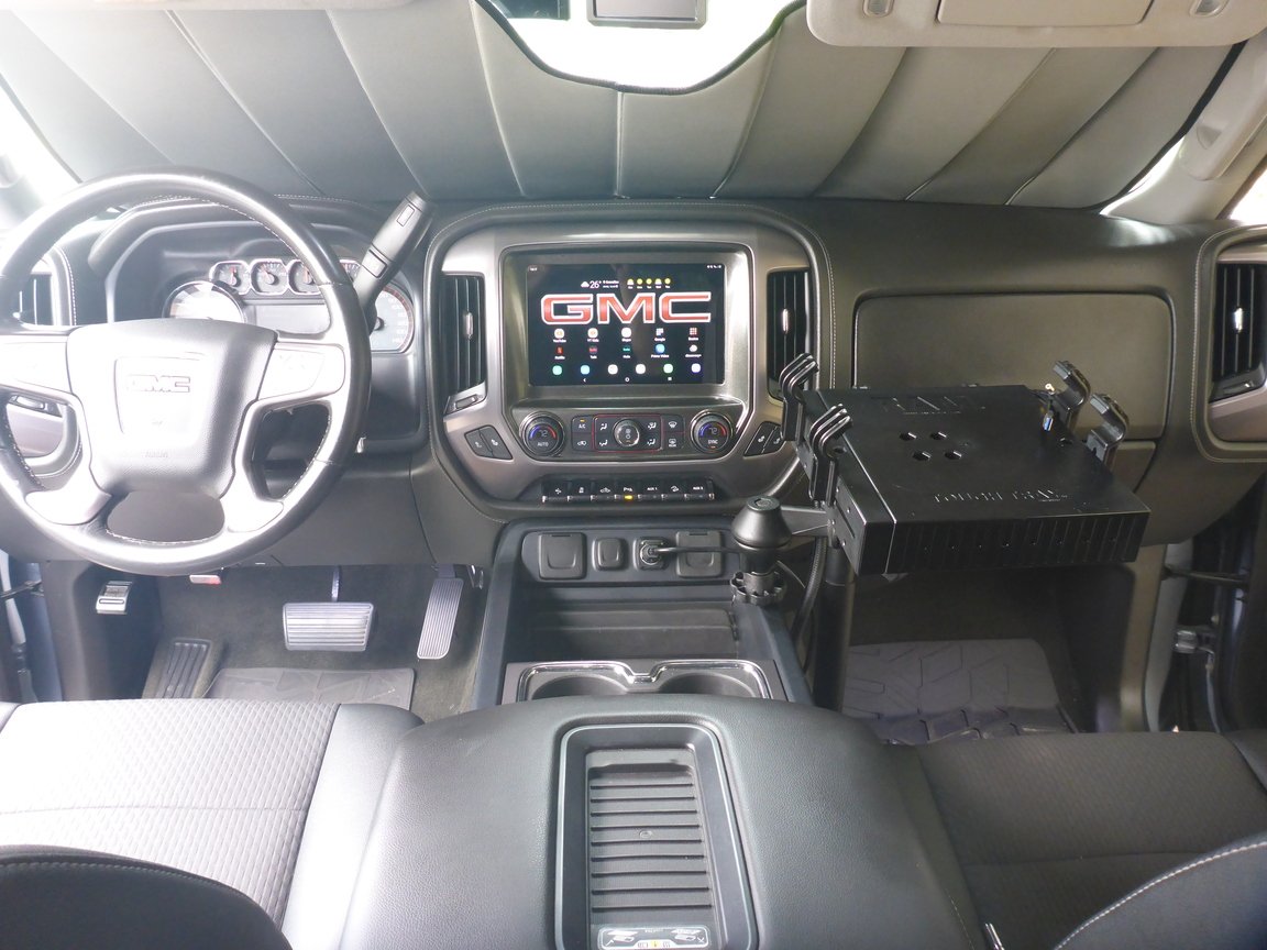

I've kept the original components in order to get the truck's cab microphone and steering wheel commands without alterations. I've drawn the original touchscreen cables into the locked glovebox in case I need to make any adjustments to vehicle settings (which I normally never touch), but I can connect the original touchscreen there quickly. You don't really lose the FM radio (except for tuning), because you can always say "tune to 95.5 FM" (I honestly only use FM for drive-in theaters and voice command for this works great). -

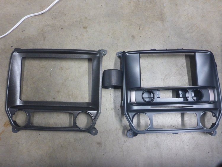

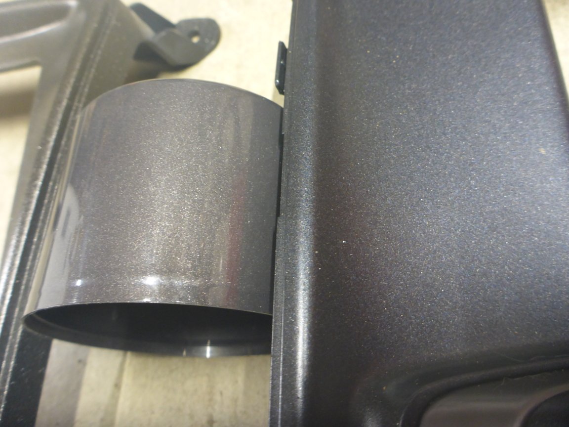

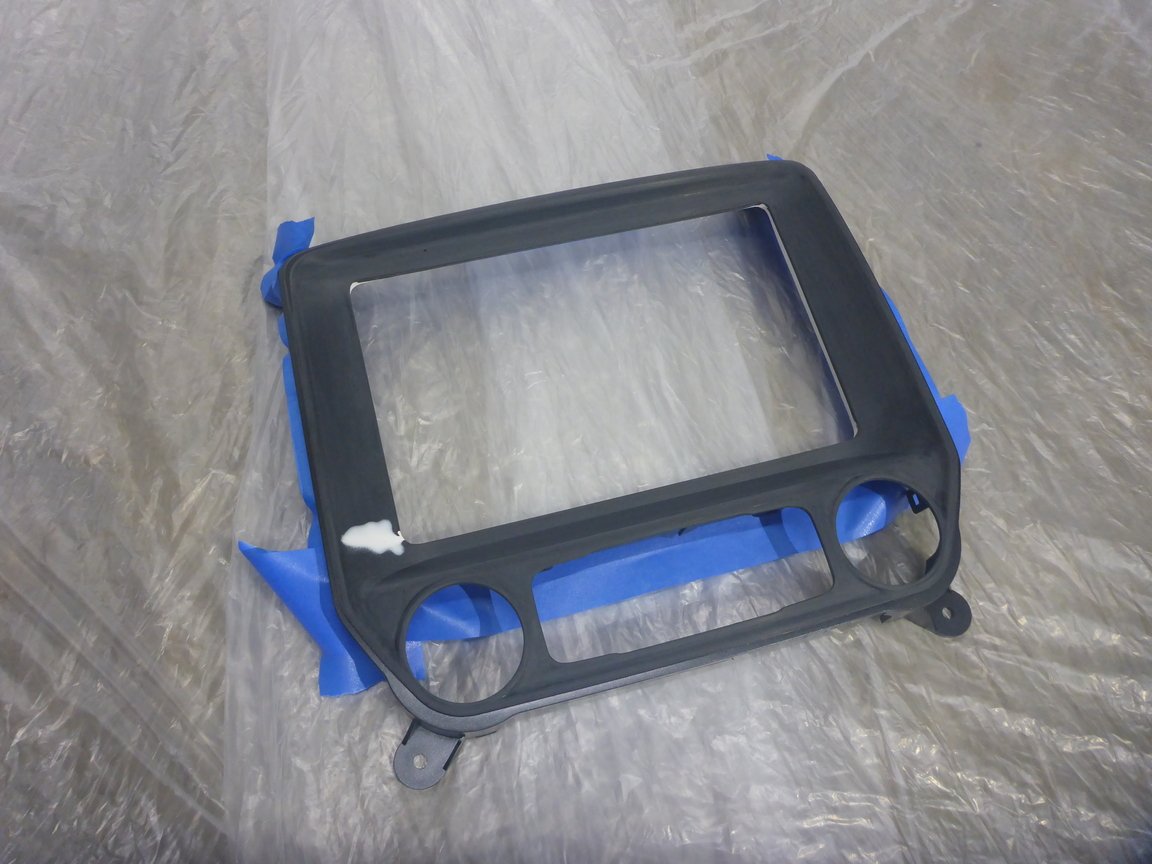

A little refresh of the topic for people who are interested; I just finished my setup. My original touchscreen started acting up - the bottom ~1" would sometimes be unresponsive to touch and I was getting frustrated by the lack of AndroidAuto features. My setup summarized: Ordered a double-DIN radio bezel Had it cut on the waterjet for a larger screen Filled up the side gaps due to bezel curvature with plastic weld putty Sanded and repainted the bezel; paint I used turned out to be a little different from the cap but nevertheless I am OK with how it looks at the end Used double-sided tape to secure an Android tablet in place and added a bracket for additional back support Wired a USB charger from one of the circuits active with ignition Sunk the CD player deeper to create space for the tablet Tablet I used is a Samsung GalaxyTab A7 10.4" 2020 model with LTE Summary of how I set everything up Tablet is on all the time, this circumvents the need to wait for bootup and also allows vehicle tracking via location sharing When the key is turned, charging begins, tablet must be unlocked only once, and will remain unlocked while vehicle in use (Smart Lock feature) The screen will stay on while vehicle is in use, that is, while charging works (Android option) The tablet connects via Bluetooth so all steering wheel commands are operational When the key is removed and the door is opened, major music apps stop, and since there's nothing keeping the system from locking, it locks after 15 seconds If tablet ever gets fully discharged and it needs a hard power-on (via power button), or there is a major I can access the button through a tiny hole with a SIM card ejection tool and press the button Some pictures: -

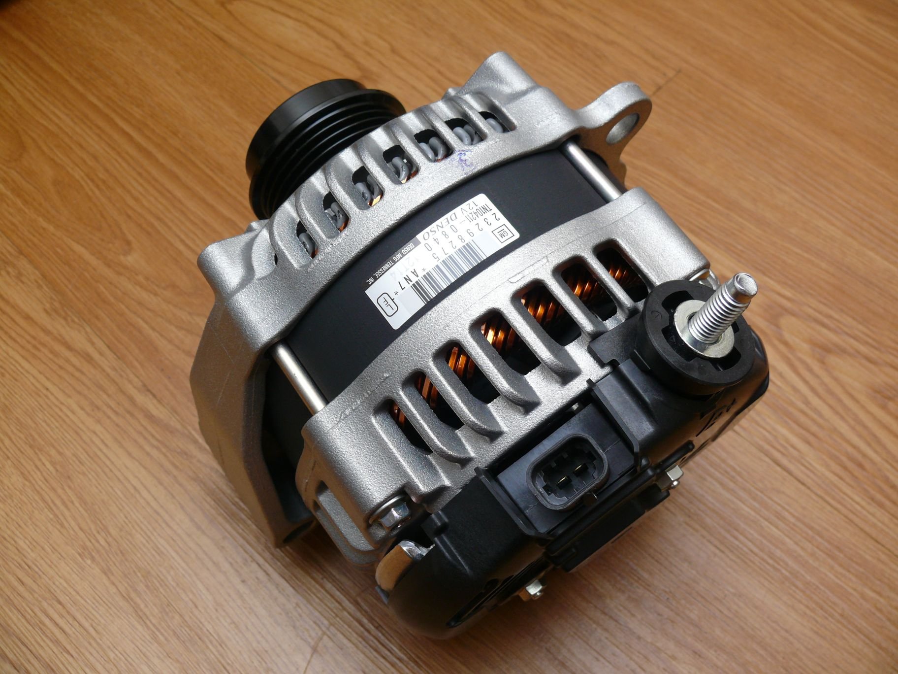

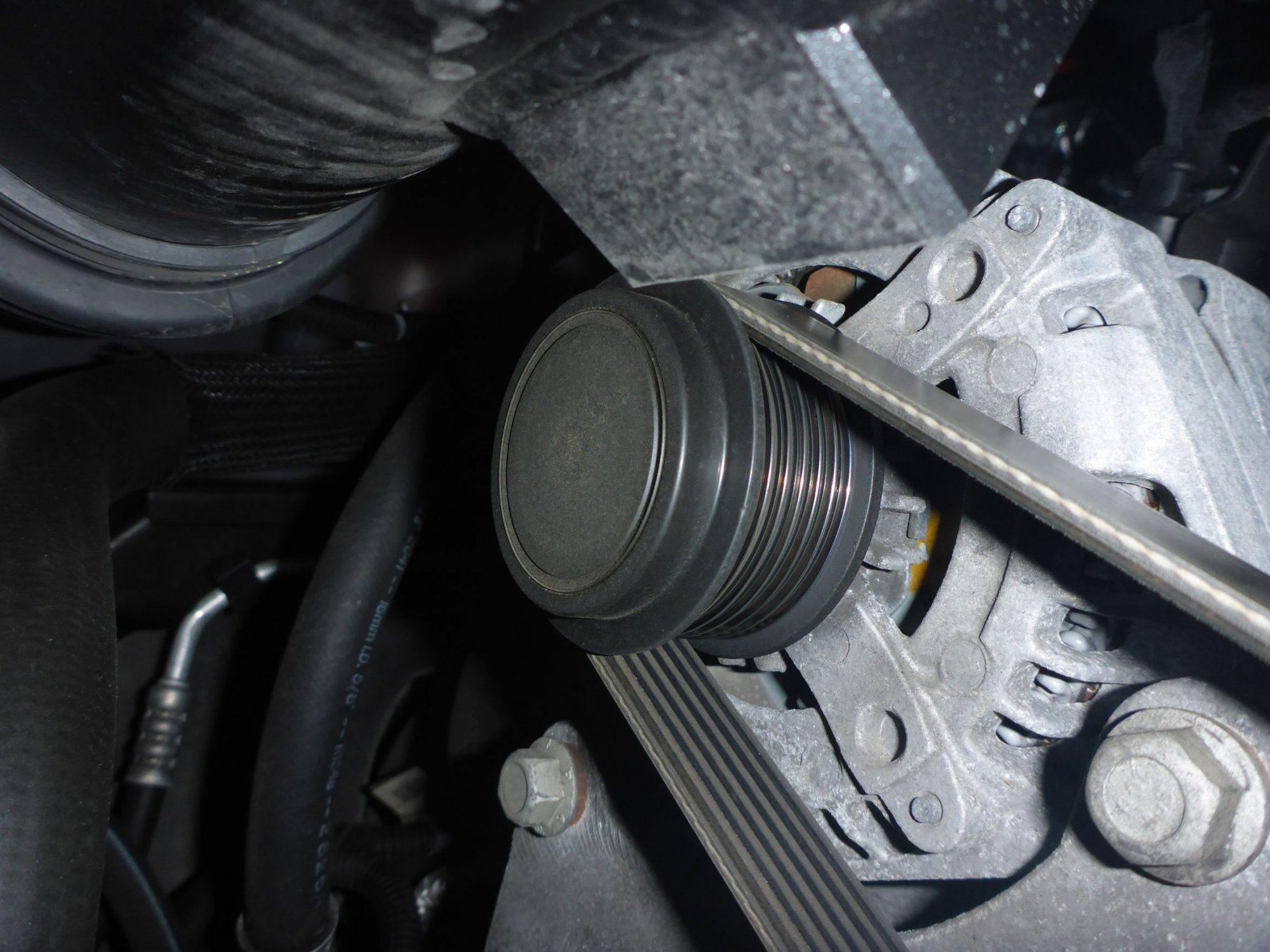

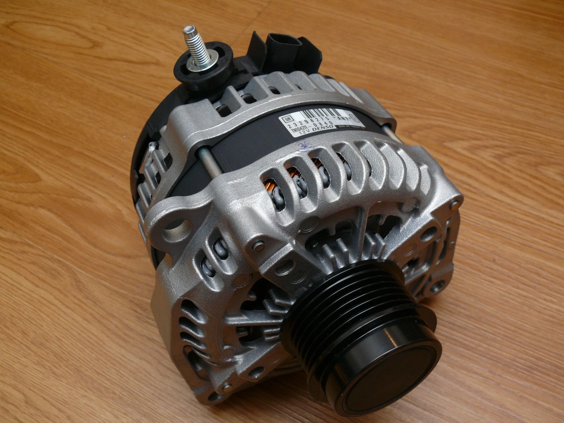

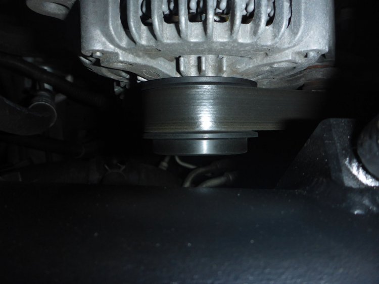

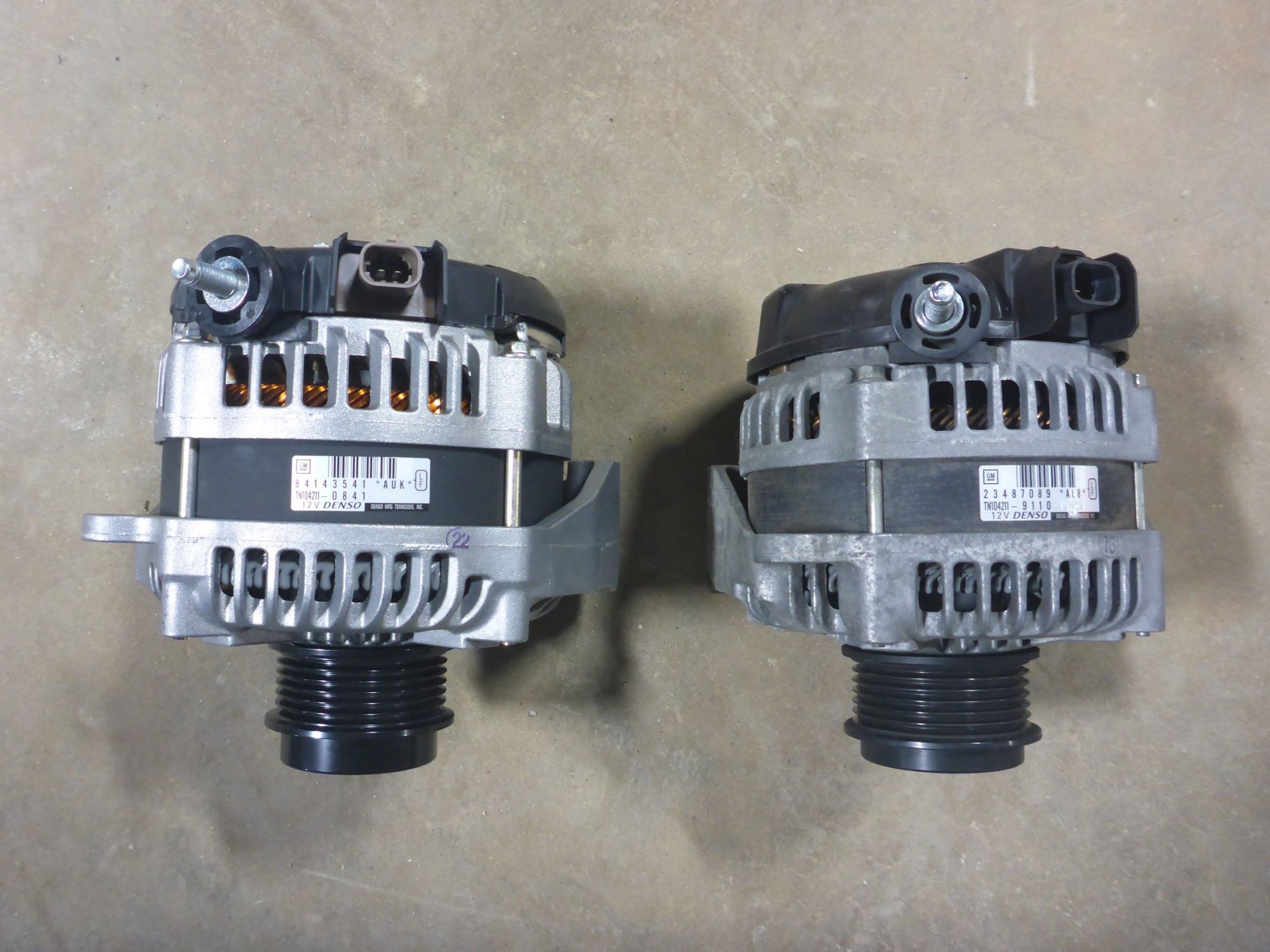

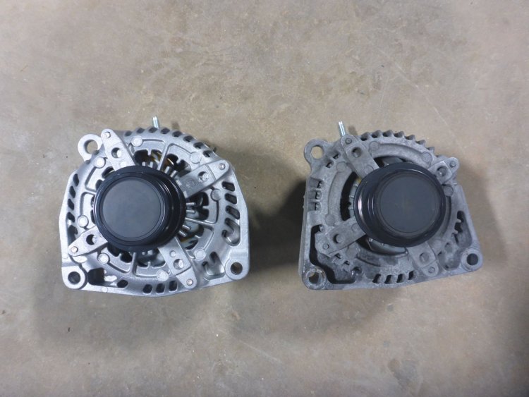

I've never seen the different pulley types but I haven't seen many of these trucks' engines either. Best I can do is attach my photos of part numbers I was referring to above. 150Amp mounted: 220Amp out of the box: 150Amp and 220Amp side by side: By the way, the 220Amp alternator has been working well for me for months now. -

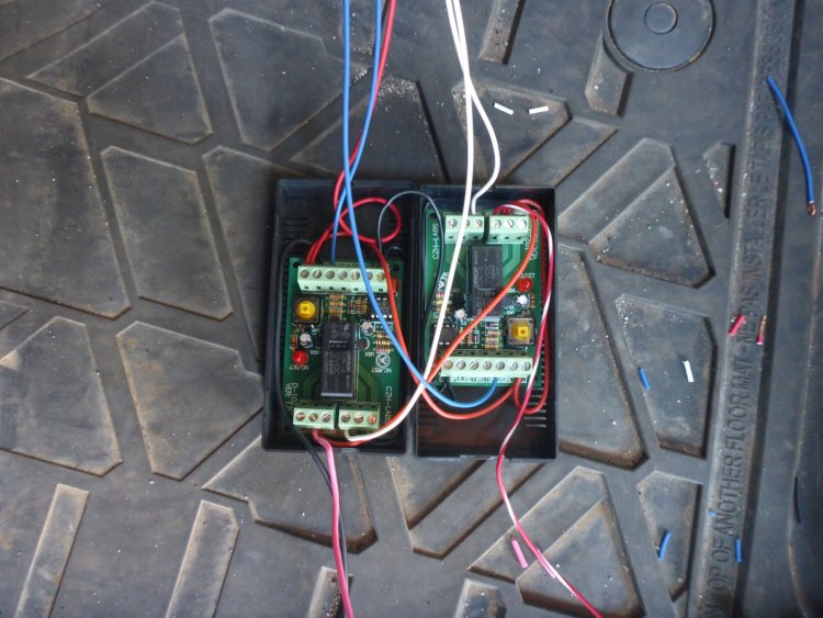

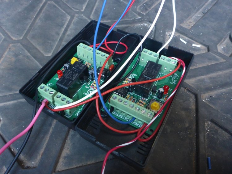

Oh I see now, I failed to see that you only need series resistors if you use a different power supply for the external trigger circuitry. One board that you've shown should be enough for two switches - the two channels should be independent. You set a pulse on the CH1 trigger input, and the relay turns on; you set another pulse on the CH1 trigger input, and the same relay turns off; same holds for CH2. If the board doesn't operate this way then it may be faulty.
There are two types of latching circuits: 1. set/reset that require two buttons where one specific button is designated for setting (turning on), and the other one is designated for resetting (turning off) 2. toggling that require one button If you don't want further complications, you should utilize the toggling type. I am looking at your previous post with the Amazon item description and I think that is the toggling type. Do you have the recommended resistors wired in the circuit? If you have even tried the board without those resistors it may be damaged.

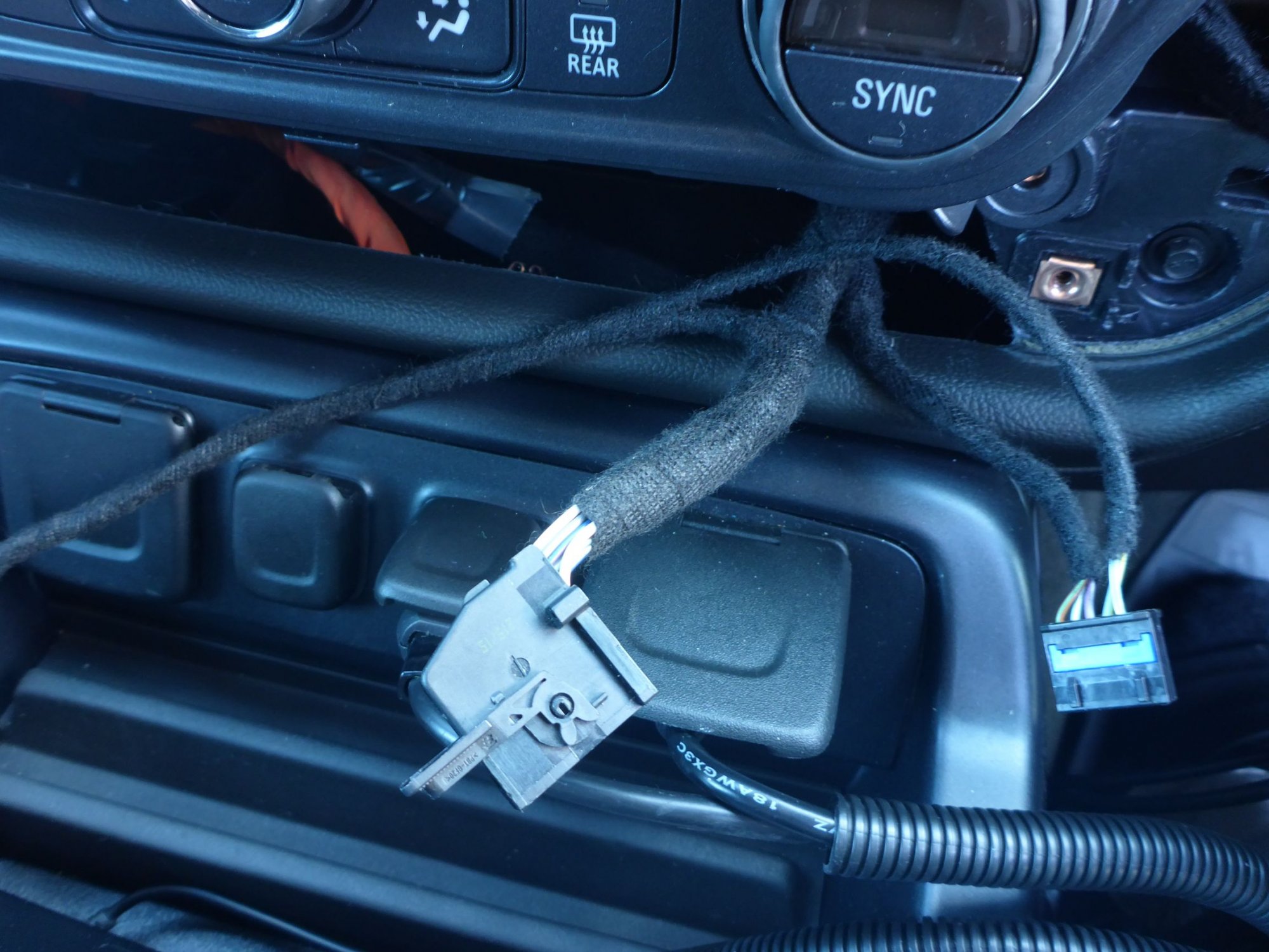

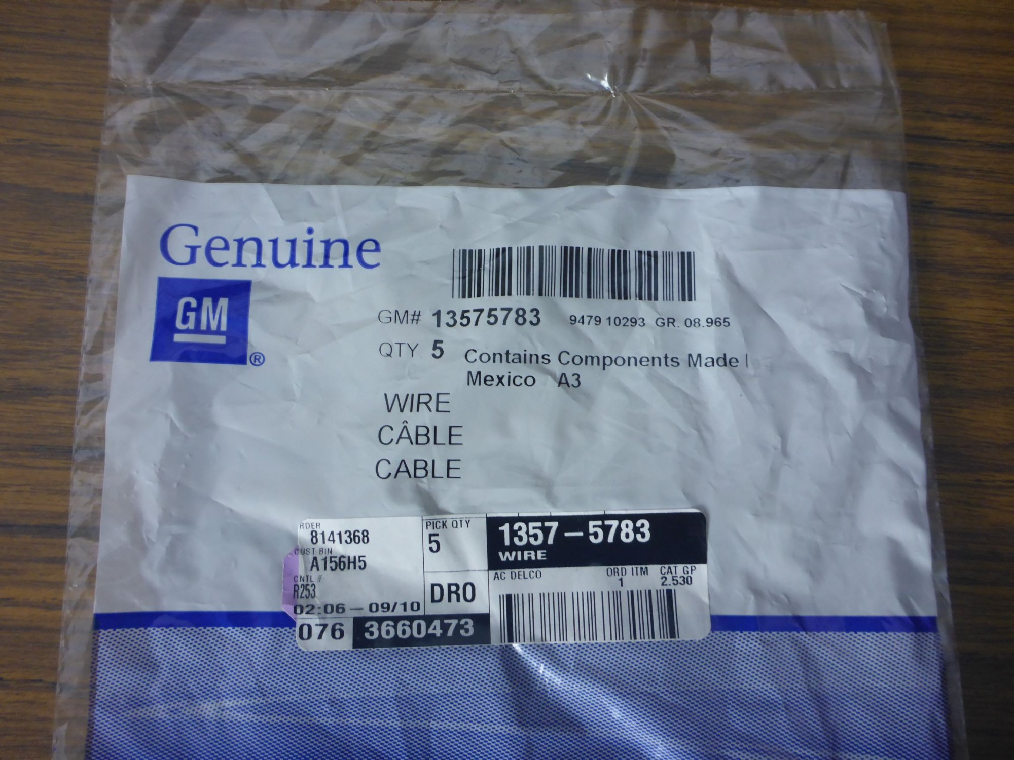

On the opposite side of what you are looking at is a tab that secures the connector housing with the lever. Insert a small flathead screwdriver from the wire entry side to release the tab and pull the housing away from the wires (it will slide out towards the opposite direction than the direction wires are coming in).

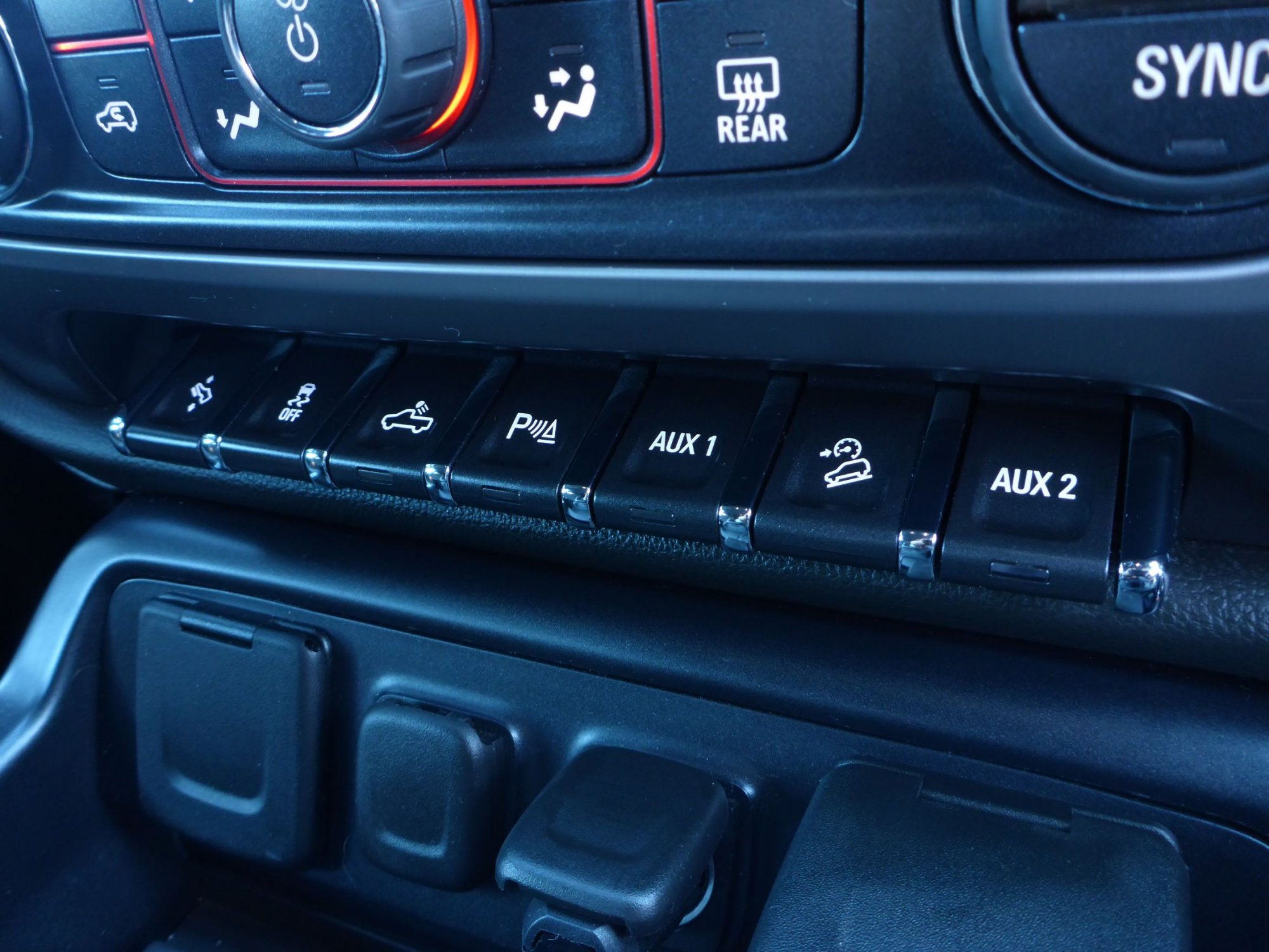

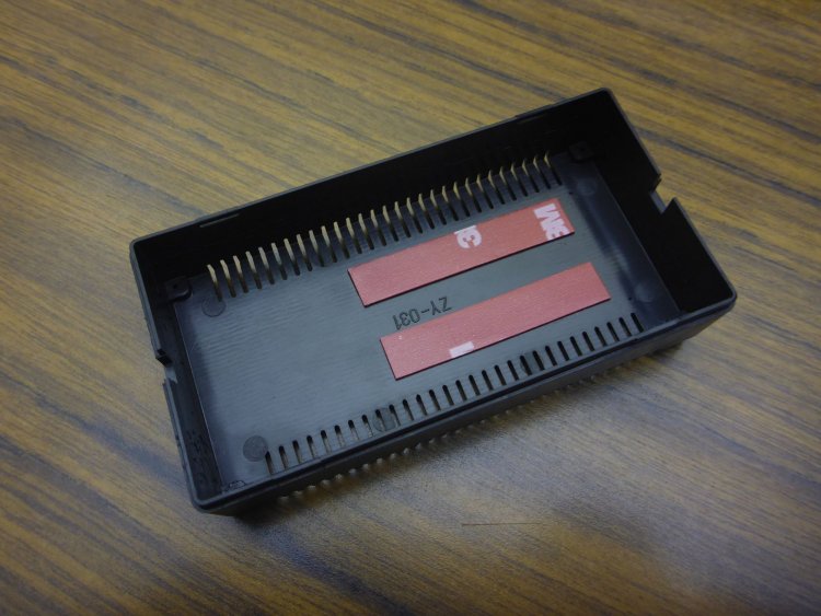

I completed my install of relay latching boards to convert AUX 1/2 pushbuttons to switches. Many options exist but the two boards I got conveniently (tightly) fit in a project box I had. Blue/red/white wires lead to the multifunction switch according to one of my previous posts, pink is constant fused positive from AUX battery, black is ground, and red/white is the control wire for my inverter from AUX 1 switch (other one currently does nothing). Relays on these boards are DPDT so I can switch a ground lead (for my AUX 1/2 indicators on the buttons), and also a positive (for whatever). It all fit nicely under the dash. For members reading this for the first time and wondering why some of us are doing completely different things, in essence, if you have a setup of switches allowing you to use a multifunction switch bank in its original shape with AUX switches, then you can retrofit a portion of the wiring to get it to work in the factory style, and utilize factory fuse/relay sockets. On the other hand, if you are in a situation where you have to combine multiple switch banks, you get pushbuttons for AUX functions (and not switches), which then somehow need to be wired to work as switches (that is to toggle relays) - when these relay latching boards come into play. Also as a note, I removed the red LEDs from these boards signifying that relays are off to reduce parasitic draw (since this is hooked up to constant positive from my AUX battery). Each of these boards draws about 3.5mA (when LED indicating normally-closed active state is removed) which is not bad if you have only a small number of them.

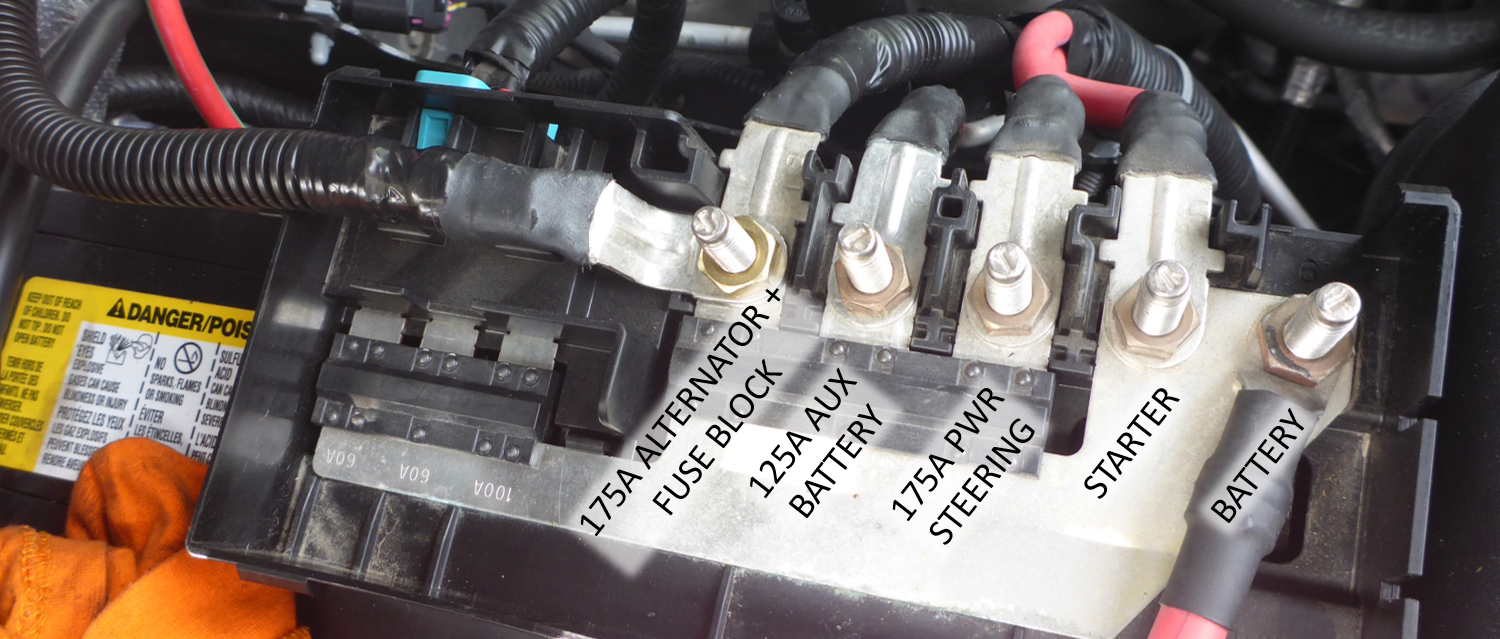

There is a small catch - the factory line from the alternator is fused with 175A on the power distribution block (on top of the main battery). Most likely I will just get a 250A inline fuse and move over that wire three lugs down directly to the power bus. Also, making that wire thicker gauge is probably a good idea to support full charging current. -

With help from member doubeleive, I am finding that 84143541 220 Amp alternator works without problems. I think that will be enough for my needs right now. -

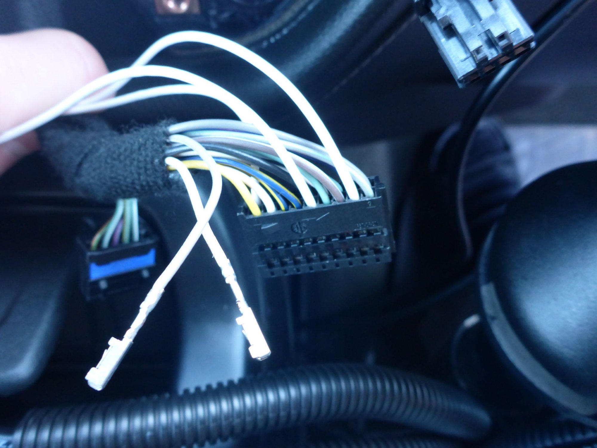

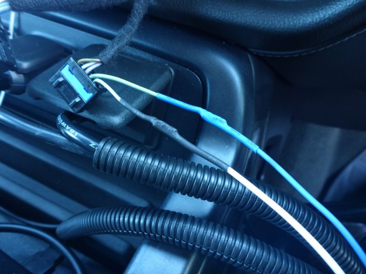

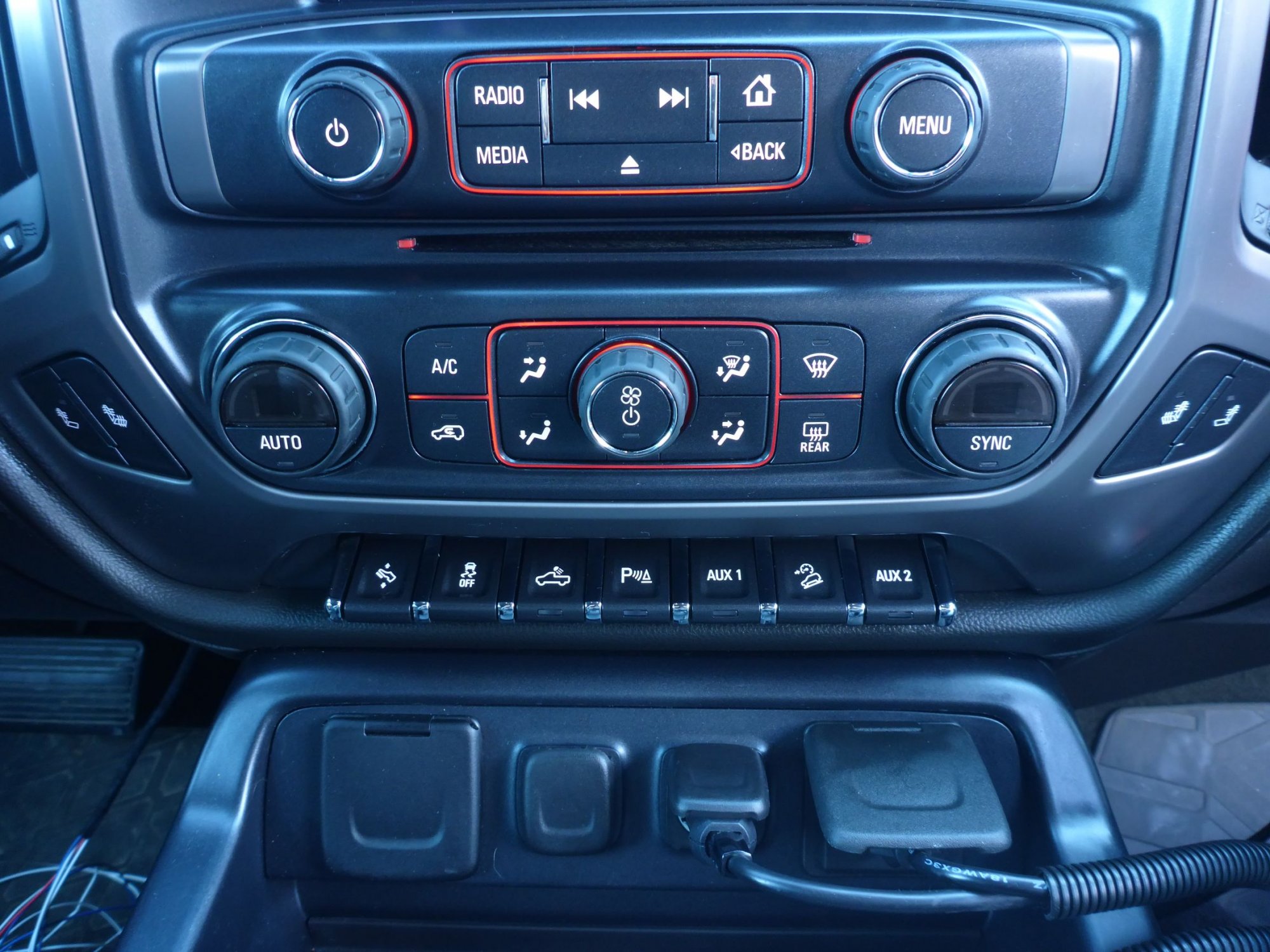

I got the switches installed; before: after: These terminated leads are required for X1 connector on the switches, but you can also just tap into existing wiring: Tapping into X1: Tapping into X2: All together doesn't look any different than factory wiring: That's it for today. On the dangling end I have 1x RED wire for AUX1/2 LED indicators (positive), 2x WHITE wires for AUX1/2 LED indicators (ground), 2x BLUE wires for AUX1/2 push-buttons (ground). Notice that the red wire is hooked up to an additional pin (cavity 10) - this is related to my mod (from previous posts) which allows me to control AUX1/2 indicators separately from the lights of the rest of the instrument cluster. I will soon post with pics of relay latching/toggling boards needed to make AUX1/2 push-buttons function as switches.
