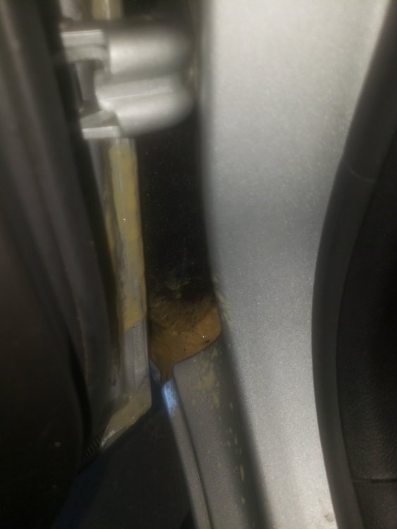

  7. I looked into mine today and found that it is easily accessible to clean out a spray some fluid film in to protect the fender. All you have to do is open the door. Lol I was spraying the fluid film through the drain hole underneath and that's when I noticed it was open from the back side.
