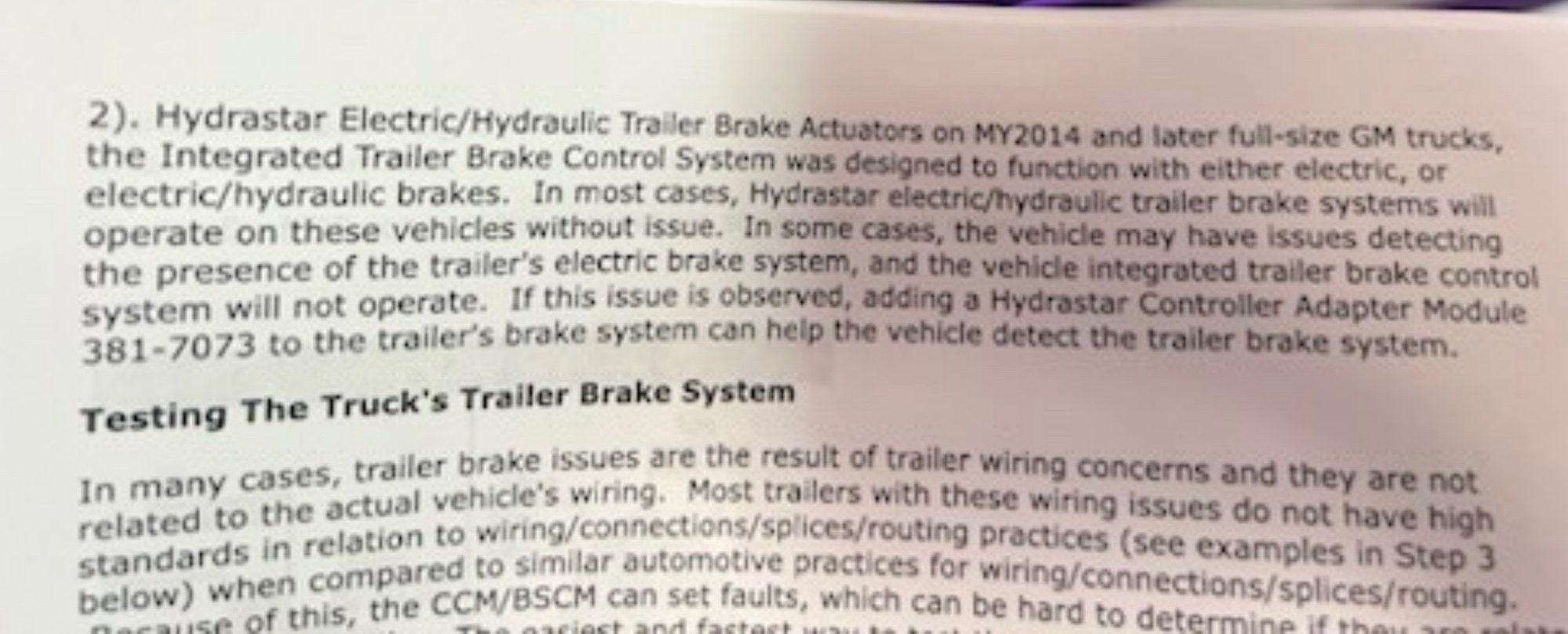

  2. FIX IS COMING FROM GM! 8/26/2023 - Our FSA will be installing a component on my 2024 3500 this week and testing it with my LQ trailer (no solar charger, just aux batteries on trailer) at our dealership. Will update with the results. I can say that I had zero issues of dropping the trailer brakes when the Hydrastar CAM was working properly on my 850 mile trip to Tennesse in July. The CAM wire was cut at some point under the truck and the issues with the trailer brakes came back. Pretty certain GM is on the right path with the part we are asking this week. Fingers crossed!!!
  3. I argued with my dealership about how it was written in the book back in 2020. Didn’t get anywhere. My husband and I own this dealership and this is my 3rd HD 3500 and each one has had to have the plug swap done. The plugs on the end of the cameras are another issue. They easily pull off the wire and there is no means of getting the plastic end of the plug if it gets damaged. We are trying to run these issues up the chain but, it is an uphill battle. With the 2024 I had trailer connection issues and had to ad a Hydrastar Controller Adapter Module on the truck (not the trailer) to fix dropping trailer brake issue. I love my trucks. Just port design in the towing department!
  4. UPDATE: Drove 860 miles with no issue. Used another trailer to move a horse and all heck broke loose when I hooked up to my trailer. Truck spent 3 days in the shop and I was told it was the Hydrastar CAM that GM told our Chevrolet tech to wire to the truck. I’ve been stranded with horses in Tennessee for four days. GM is finally listening. Our field rep for GM is hard in this issue. I went and bought a 2022 3500 JUST to tow home. It works just fine so far. I was told NOT to connect the 2024 to the trailer until it’s back at our dealership. Tgakful to have a spare driver with me! ********* My 2024 3500 had similar issues with my LQ horse trailer. It required installation of a Hydrastar Controller Adapter Module 381-7073. My dealership worked with GM tech to install it ON THE TRUCK instead of the trailer. This fixes my issue with ANY trailer (hopefully!)
