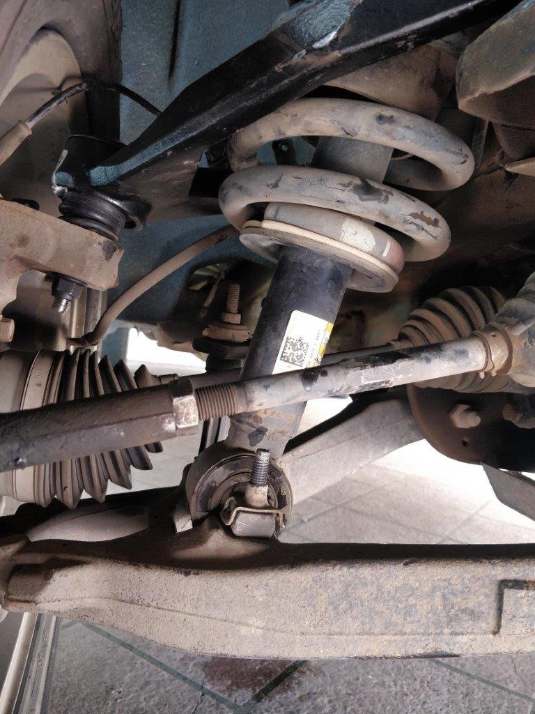

  2. I'm amazed how ridiculous is the stock front suspension downtravel on these trucks. I initially measured for reference exactly 1,5" when I had the 3" front spacers installed with RC forged UCAs, difference from hub to fender. This was without the bumpstop rubber, UCA was resting on the chassis. I thought that the quite poor ride quality was due to that. So I decided to lower the truck to get a bit more downtravel, to 2.25" (readylift). And to my surprise I didn't get that 3/4 inch back in downtravel... No...only a mere 1/5" more ! And the UCA wasn't even touching the bumpstop ! Strut was simply bottomed out...So my 2.4t 20feet long 4x4 truck has hardly 2,4" of downtravel on its front struts. Lol. Even my business car Kia Sportage has more wheel travel...This is maybe explained by the so stiff springs they have. They hardly compress when jacking down. Then I did put back the rubber bumpstops but these are only slightly in contact with the UCAs. So with a 2 inch level kit on stock UCA I guess that full downtravel is still almost here, that's why ride quality isn't too much impacted. Know I just need to find longer/smoother springs...but impossible to find the spring rate on mine.

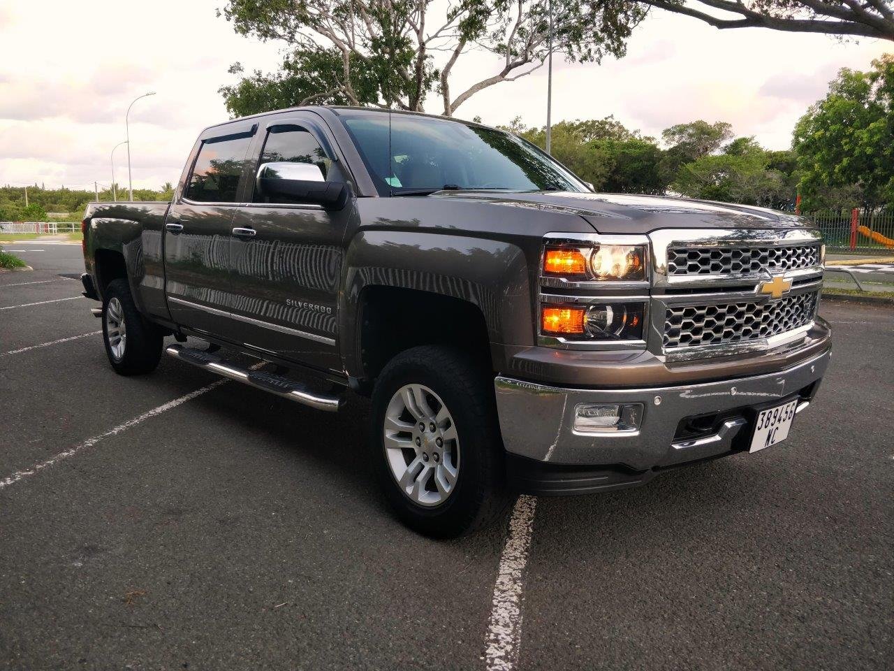

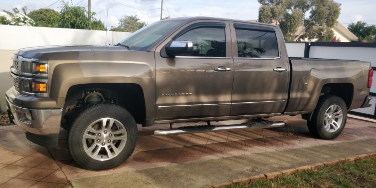

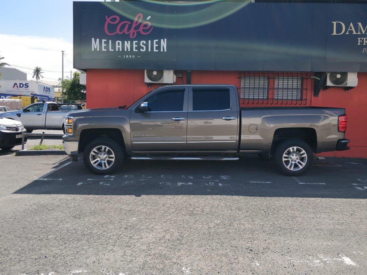

  3. Here is my setup, Readylift 2.25" front, RC forged UCAs, 3" rear blocks. Rake is now 1.3" which is fine for me as I didn't like the previous "leveled" look. Furthermore, side steps are now exactly parallel to the ground. Downtravel is almost as good as stock with RC UCAs, & drivability is very nice compared to 3" front spacers installed before ! Since pics taken I put back rubber bumpstops for smooth operation. No more "clunks" ! Robin

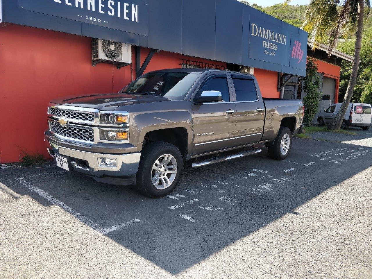

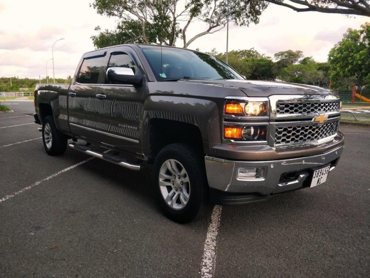

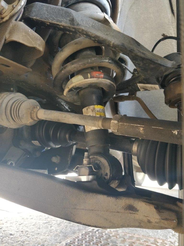

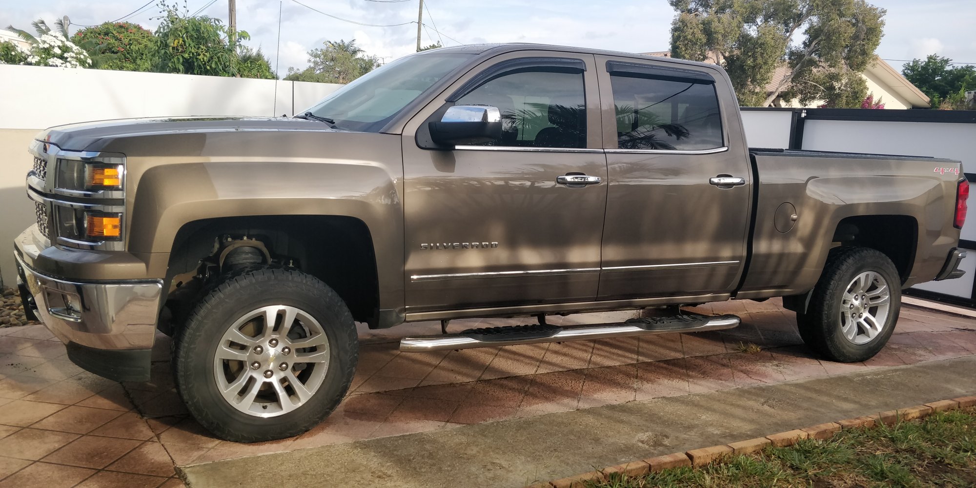

  5. Already posted some pics few weeks ago but it's always a pleasure to see and share ours trucks ...And as a 2014-2015 MY owner I need to compensate for all those 2016+ ?? Also a pic of the Rough country forged UCA I installed to relieve poor BJ angle (3" front lift from previous owner). Ride is way better (or much less worse ?) In next few days I'll install the 2.25 Readylift instead, to get a better ride with more downtravel, have better CV/Steering angles too & get some rake back. I wanted to go 2" but may be too low for the UCAs. And I can't make my mind for the future : stay lifted or go full stock with the best ride quality….Cause having 3.08 gears, big tires are not an option, I already made that mistake on my previous Tahoe and I didn't like it at all (33" vs 31.5"). Robin
