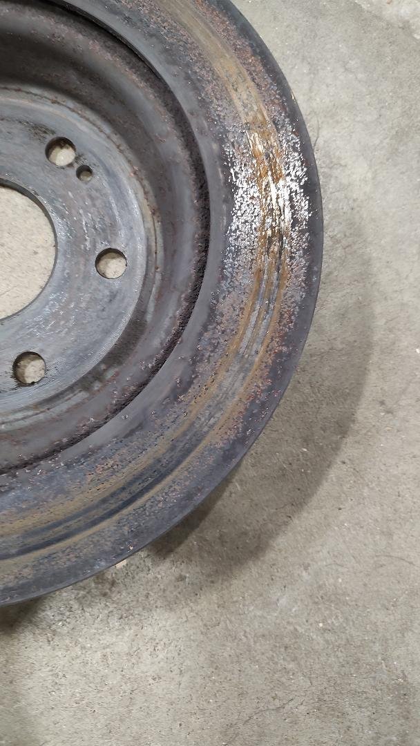

  9. Supply issues are still a issue hard to imagine that it is... I went with new rotors and pads(aftermarket) all the way around @ 30k. Pad life was showing 88/90% and they had alot of pad left but I was getting vibration issues from the pad material imbedding on the backside of the rotors, due to what pad material gm has to use anymore.

  18. Felt like more in the front but could feel the feedback throughout the drivetrain. After reading that some were having their brakes wear out prematurely I'd thought I'd investigate more. After seeing the backside of the rotor and conversing with a bud of mine that works at GM testing decided to change out the fronts first which took most of the vibration out but the rears(pic was the rear rotor) was looking like the fronts and could still feel it some, so just decided to get over with and change them out and move on. The rears are abit trickier to do than the fronts due to the electric parking brake. Never thought I'd have to change them out with such few miles and the way its been driven. Chased a vibration issue with my last vehicle but it was deeper in the front axle than I was willing to go at the time. Has your truck had anything done other than change of rubber? Level, different rims/offset, or suspension? Good luck with your quest!
  19. If would get slightly worse and depending how much they were used. Not hard on them but when I was on a trip and went through the Appalachian MTs. and was using them more it was making it worse, felt it more at certain speeds too. Thought the same as it could be a balance or wear issue, it isn't leveled, so when I did a oil change and rotation I checked the rotors and found the buildup.
  20. My '20 AT4 I started noticing a slight vibration before 20k and was getting slightly worse with the more miles. Found that the brake rotors were getting a buildup from the pads. Finally had enough around 30k and replaced all and vibration is gone. There was alot of pad left when I changed them and the wear indicator was at 89% front, 91% rear. The outside of rotors looked good but backside looked and you could feel the buildup. The pad material the GM is using is causing this, due to certain state regulations. Had to take the truck in to the dealership to get the pad wear indicator reset. Asked the mechanic if he has seen this issue much and he has and said just turning them won't help because its the pads. -Grover67
  21. Check the inboard side of your brake rotors for what looks like buildup. This will cause vibration issues, it from the crap brake pads being used, thank you comi foria... -grover67

  25. Rears got changed out today, rotors looked like the fronts but not quite as bad, 93% left on wear pad indicator. A little bit different to do. Set the brakes into service mode, disconnected battery and got first side apart. Couldn't get caliper back on. Called a buddy of mine, had to use a 12v battery to retract piston fully and then was able to compress it the rest of the way to get caliper back on. Reconnected battery, took out of service mode and no codes. Will do break in procedure on pads tomorrow. So their done now -Grover67
