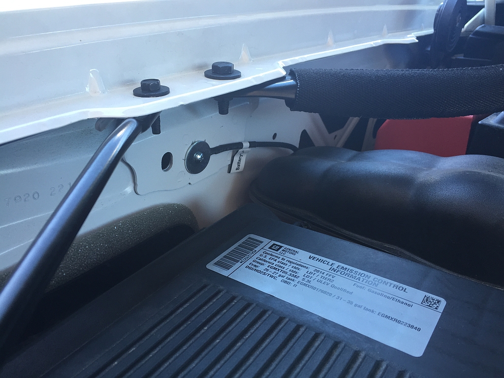

There's 2 pieces of steel spot welded there, so it's pretty thick. I used a sheet metal self tapping screw.. Depending on when you bought your harness, there looks like there is 2 or 3 different grounding wires. I just recently purchased the harness and there were only 2 ground wires. The first picture is the main one...the other one (the capacitor harness) was grounded the same way to the frame next to the relays (on top under the fender washer). This is under the huge plastic shroud covering the radiator, next to the passenger side headlight...- 3,363 replies

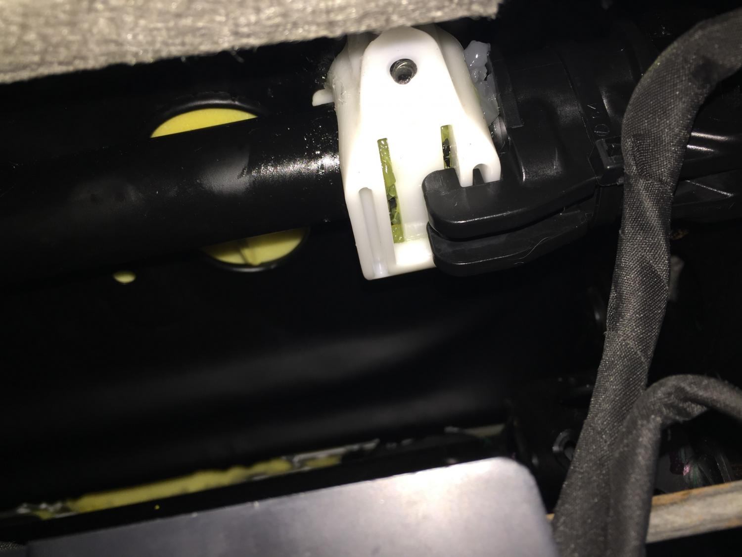

I had the hose clamp in place, lasted about a month or two before it started slipping. Tried to tighten, but would still slip. Went to the dealer for a recall (15304) fix and asked them to change oil and take a look at the seat. They acknowledged the seat issue and the svc mgr said they have a fix, but it doesn't always work. At least he was being honest. They performed PI1183A http://oemdtc.com/12126/front-seat-lateral-movement-andor-click-type-noise-while-driving-2014-chevrolet-silverado-gmc-sierra Seems solid so far, only time will tell if I need to go back to the hose clamps. Svc mgr said he could order new tracks but he is supposed to perform PI1183A first, and to let him know if it starts slipping again. Appears to be a newer than PI1376. Didn't see any shims mentioned and I do see that black-ish plastic retainer that's in the last picture of the instructions linked above.
