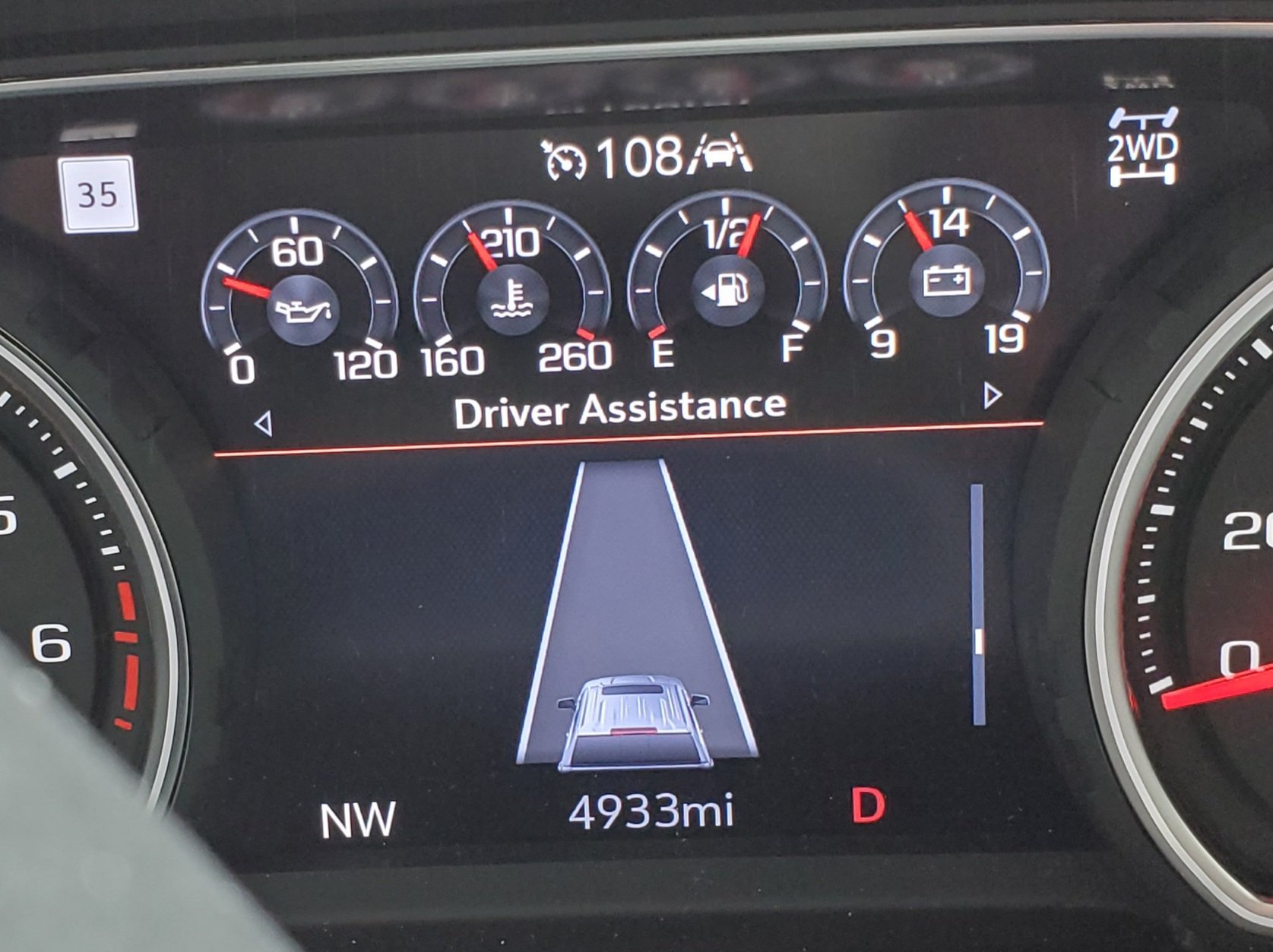

I think a this point everyone knows about the speed limiter on the trucks (I think there are 3 different levels for the 1500's). My 6.2 High Country is limited to 112 mph. On a ~15 mile straight stretch of road with no traffic (it was 6am) and discovered Cruise control is limited to 108 mph. This picture was taken after my journey in Mexico was over and I was safely stopped. I also learned that if you have cruise set at 108, the truck takes it's time getting from 100 to 108 (way longer than if you do it manually), and that if you use the pedal to get it to 112 so the speed limiter kicks in, cruise control is turned off. I have experience driving cars fast, don't try this at home without a professional's help.
