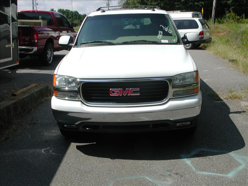

I purchased a 2003 Denali grill for my 2003 Yukon XL, however once I held it up to the stock XL grill I noticed that the headlights and lower marker lights are in different places. My question is do I have to get new headlights or do I have to get new mounting brackets? Or can you switch out the grills at all? I am sure I am not the only one lured into this trap. AHHHHHHH
Thanks for any help!!!

You can use the same headlights, but you need new turn signal lenses. You will also need a new bumper cover as the regular Yukon bumper wont line up right with a Denali grill.
