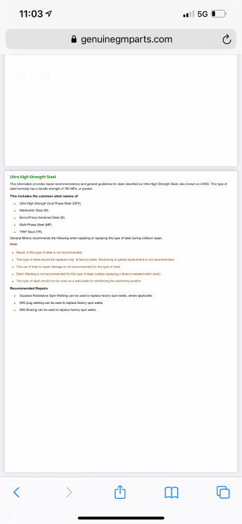

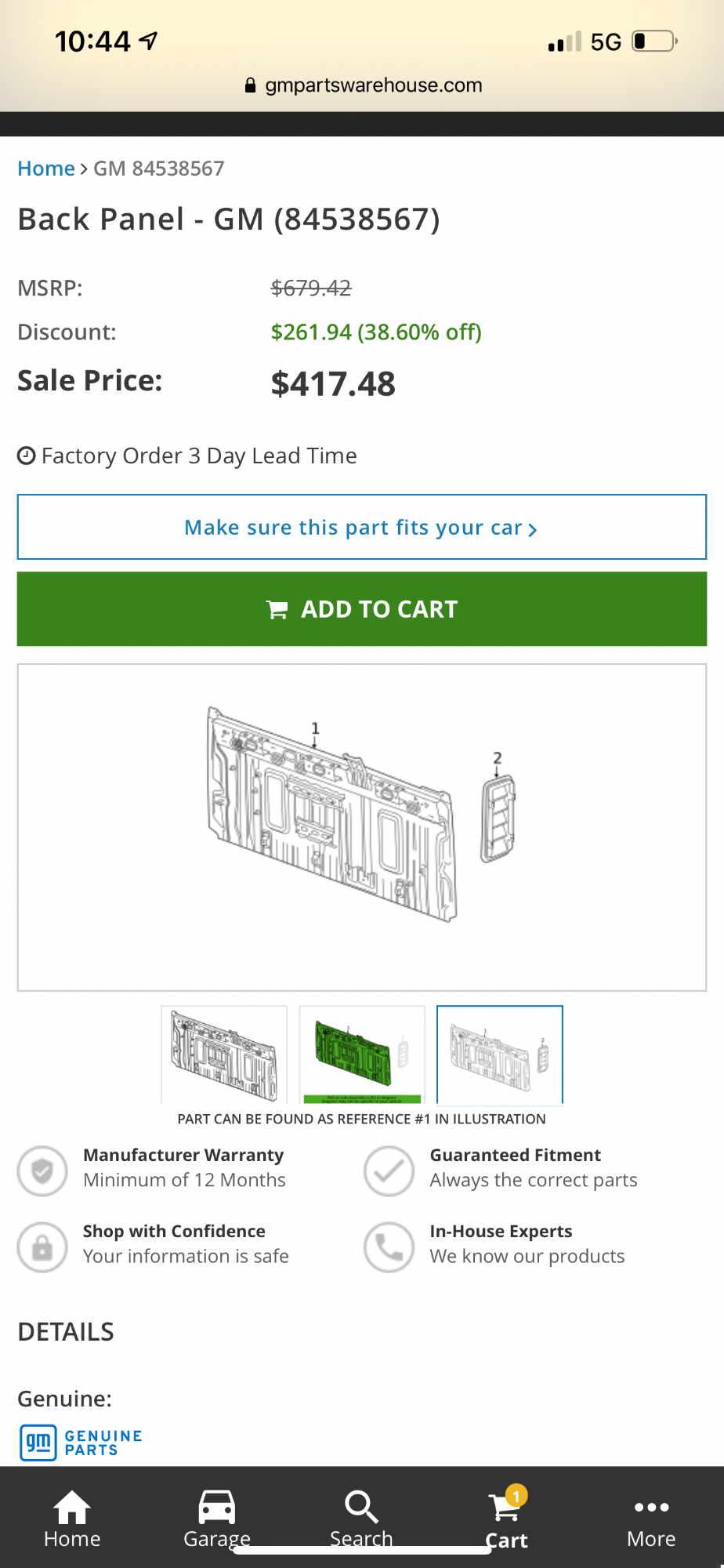

9C14C1C6-D479-4CBB-AEE8-9BE87D69C71D.thumb.png.b72b167d62c727565497900c65f30c0e.pngI was hit. T-Boned. Frame damage. Insurance due to cost won’t total it. Took it to a repair facility. Lots of issues but here’s the major one I’m questioning. Rear of cab F- Panel or rear panel. Seems to be reinforced steel was repaired. Doesn’t look right. And GM seems to state you should not repair but replace this part. Truck is back together I won’t sign for it.
