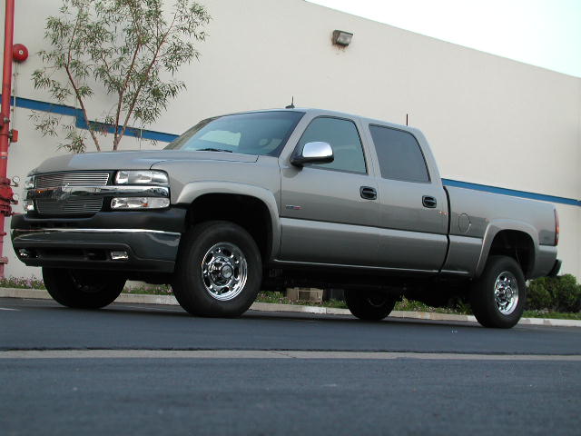

My latest truck accessory
Z71
Even though it's my latest accessory, I have had it for awhile now. and I Love it. Since it was installed, I have yet to listen to a FM station.
