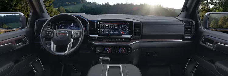

I apologize if this has been discussed already (checked and didn't see anything). GMC has finally updated their website for the 2022 1500's. If you scroll down, there is a section labeled "First class interiors" with pictures showing the dashes. You can click left and right to see the different trim levels. Something that jumped out at me was the placement of the two center air vents. On the higher trim levels, they are placed above the center screen in a horizontal fashion. On the SLT and Elevation, they are placed on either side of the screen in more of a vertical layout. There are some other differences such as the start/stop button, radio volume knob, and center console. This is the first time I have seen this as all the updated interior shots I have seen so far were of the higher trim levels (Denalli, AT4 etc). Hopefully local dealers will start getting them soon so I can see in person.
