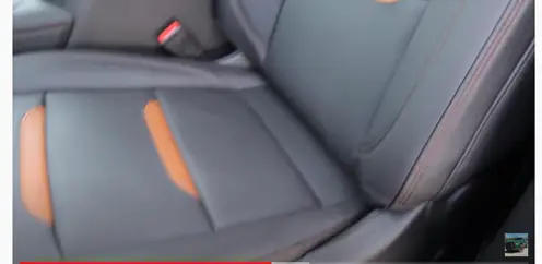

  9. I have a 2020 AT4 and recently sat in a refresh AT4 and I can say with certainty they are improved/slightly softer. stitching is slightly different along with the cover and padding being softer but yet firm. They new seat was more comfortable brand new then my 2yr old seat. They might still be too firm for some but IMO they are improved over my '20 at4. Can't speak for other models but I'm assuming they changed all leather versions as they all seem to have slightly different stitch lines. They now use the same cover/padding design as the 21+ yukon. I am unable to locate a part # for the refresh but may end up ordering new cover and pad for a 22 refresh once available. 2022 refresh 2021

  14. Do you notice any changes with the seats with quality of leather and overall feel? I sat in a refresh AT4 this week and couldn't believe how much softer and better the driver's seat feels compared to my '20 AT4. However, I've read here a few times that there was no change with the refresh. When looking closely the seams of the base seat cover are different which tells me minor changes were made.
