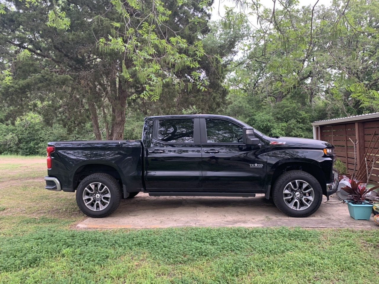

  2. Thank you. Set at full 2.0” lift for the 3.0 diesel. I also added a rear block to maintain about 1.0-1.5” rake. It surprisingly looks level but there’s still a rake and I have some wood and deer corn in the back. I have not noticed any sag yet

  8. Former Raptor owner here and could justify getting King 2.5’s (me personally) and I plan on doing no true off-roading. I pushed ordering off too long and when ready to pull the trigger the wait time was 5 months. I went with Bilstein 6112/5160 combo and am just 100% absolutely happy with the ride quality of my truck. Are they as good as the Kings - no of course not. But as someone that was willing to spend King 2.5 money front and rear to get a better ride, I will say I’m just very very pleased with how these 6112/5160’s ride - and that’s predominantly city potholes, rough roads, speed bumps, highway miles and towing. The only off roading I’ve done is on my farm in 2wd that a freaking Toyota Camry could handle. If you think that’s what you want I’m willing to bet you’ll love them for a fraction of King price. I have an LT 3.0 Duramax, set the front to 2” max setting and got a true 2” lift. Also put in a rear block since I tow and like having a slight rake.

  11. I used the top setting and got right at 2” front lift which is the advertised lift for the 3.0 engine. Rear was exactly 2” too. Went with 27/65r20 tires which add 1/2” so a total of 2.5” all around. This keeps the same factory rake that my truck had which is slightly under 1.5” - I like the look and do a bit of towing so wanted to keep that.
