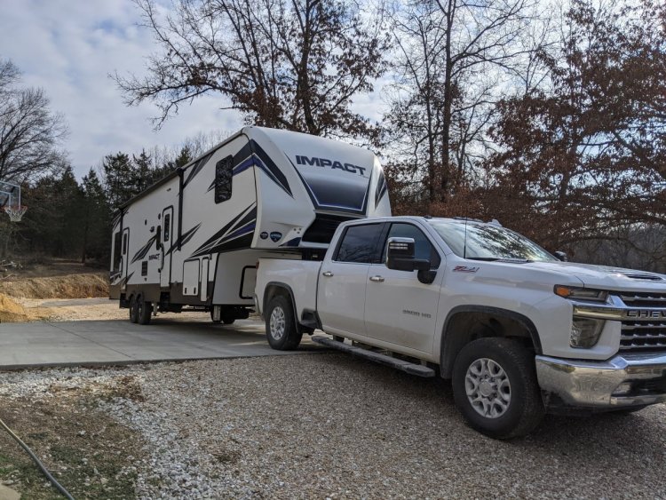

Alan Juden replied to Mardo's topic in 2020-2026 Silverado HD & Sierra HD
I have a 2020 Silverado 3500 and went with a 2018 Keystone Impact 351. Picked it up in Waco, TX and pulled back to St. Louis, MO area. Truck did great! I also had the dealer swap out the 5th wheel for a Reese Goosebox 20k. -
