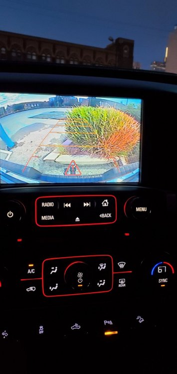

  18. I had it installed about 7 months and I blasted it with my power washer and water got in it. I contacted Dorman, they said that it was under warranty and gave me the Amazon liason phone number. It's been replaced for 4 months now, that picture above was 2 weeks ago. As with any Chinese crap your mileage will vary, but they will replace it. I have the number should you need it.
  19. I replaced the one on my 2016 with a Dorman. The picture is a little better but the haze is gone. It wasn't too bad to replace, I had to drop the spare tire. The attached picture is at 545 AM, so it was between night and daylight, as you can see above my dash. Dorman 590-111 Rear Park Assist Camera Compatible with Select Chevrolet / GMC Models https://a.co/cKHua0r

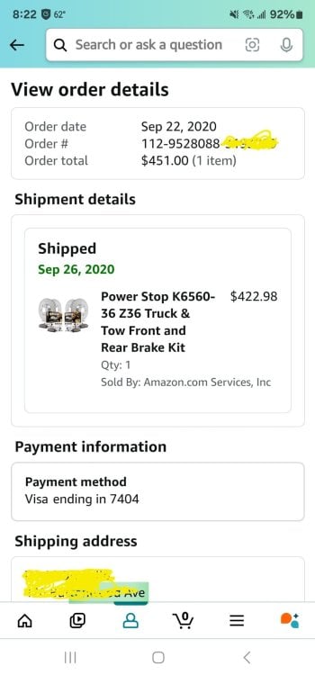

  22. On my 2016 I replaced the pads and rotors with Powerstop Z36 and they seem to be very smooth and brake well when towing a trailer. I did them at 60,000, passenger front was shot and the rears were squealing. Sad that I paid 400 at the time and now they're 518.
