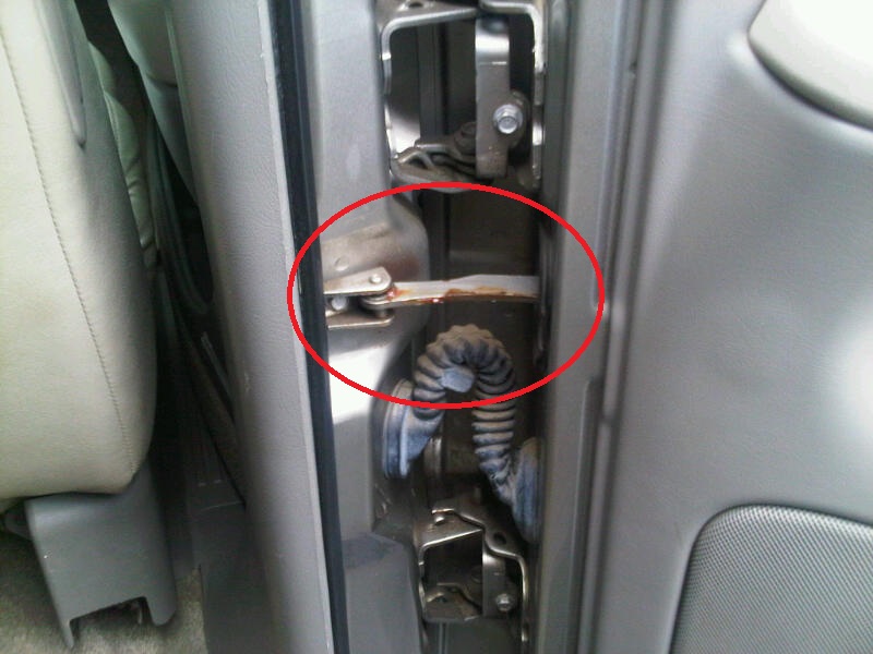

Another Name For This Part?
I've replaced this part on a few other cars in the past, and it was always referred to as a "door check" or "door damper". I've search high and low for this for my Suburban, but it must be called something else. Anybody know what this thing is called?
The official name is..."CHECK,FRT, S/D" for the front door,or "LINK,RR S/D CHECK" for the rear door.
BTW....Part number for the front doors is 15073407,and part number for the rear doors is 15173409.
