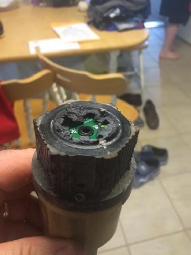

Recently my 07 Tahoe LT had a service four wheel drive message displayed, the codes were C0306 and C0327.
After researching the codes I found two possibilities.
1 - The front actuator, which I replaced with an oem actuator.

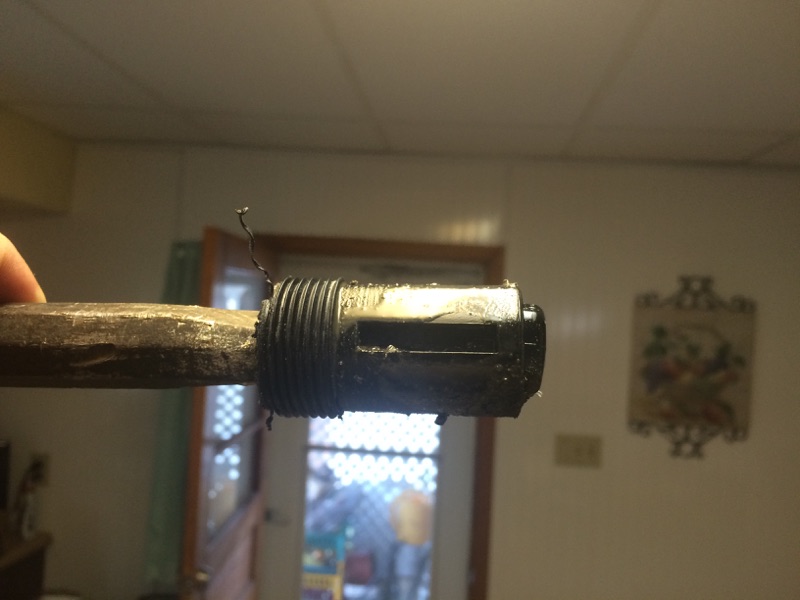

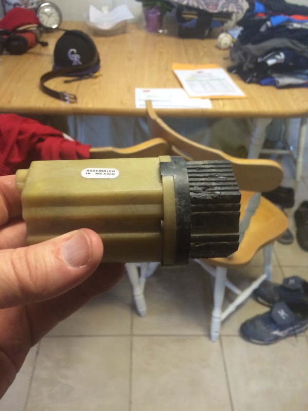

There is more to this event though. When trying to replace the actuator, which was installed December 2nd 2013, the actuator broke off at the threads of the axle housing with very little effort / force, it appears to me to have been a defective unit.
Please view the attached photos.

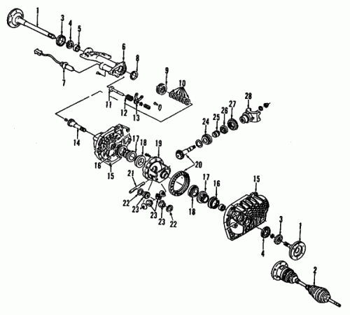

When the actuator broke in half, there was a thin shaft, 4 or 5 washers, a spring and a half moon machined piece that came out as well.
I am hoping that these were internal components of the actuator that when the actuator receives power from the transfer case encoder motor the components then move forward to advance the front differential so that both front wheels are in drive. Let's hope I am correct, if not I am looking at the front differential actuator pieces that fell out.
