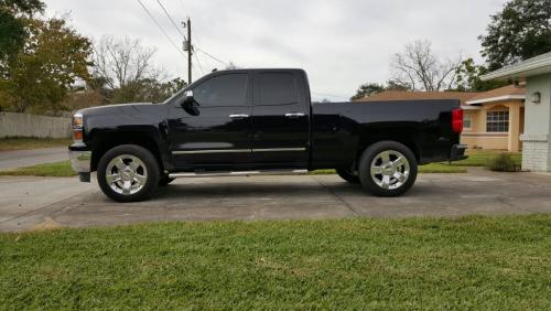

Yea if the mirror has 4 studs you will have to drill the 4th hole.
Alright I appreciate it.
