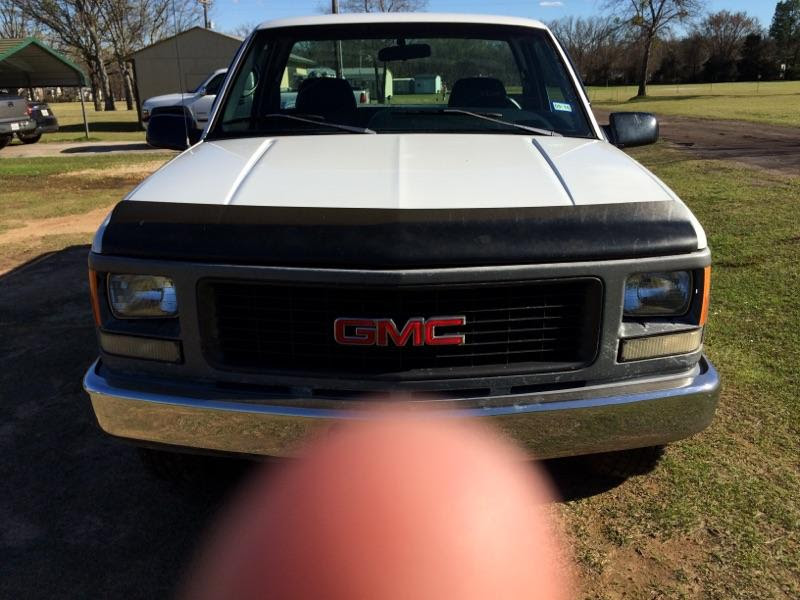

I have a 1995 GMC 2500 with the single glass headlights was wondering if I have to change the core support to update to the rectangle headlights? This is my truck now post-156336-0-42049000-1459563875_thumb.jpg
you'll be fine on the core support but will have to change the whole grill and the wiring for the lights, rectangle lights have 2 bulbs each, high and low beam. And i think the blink/parking light lense is a different size with the other style also but not sure.
