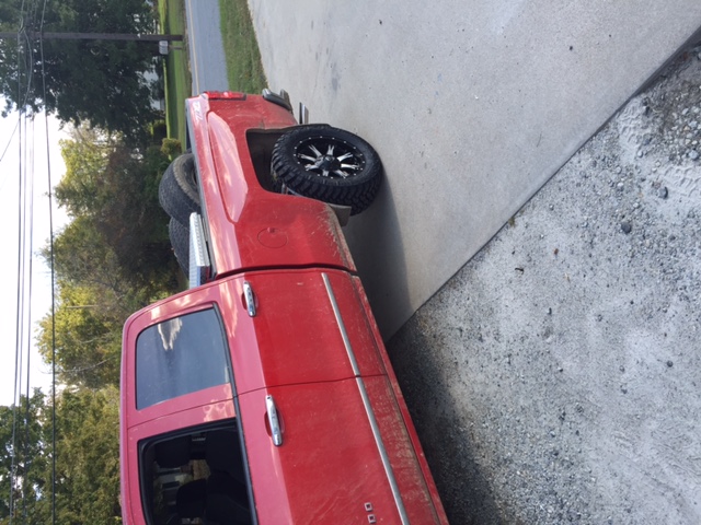

Hello, I currently have a 2014 Silverado 1500 v6 LT 4WD Double Cab. I have installed an after market exhaust, as well as 33x12.50r20 Nitto Trail Grapplers. The wheels are the 20x9 +1 offset Fuel Nutz Black Machined. I also have a readylift sst 2.25" leveling kit. Its just the 2.25" disk in the front NO block in the back. After months of looking for the right set, I just recently purchased the tires and wheels. I knew I either wanted the Toyo M/T's: 285/55r20 or 33x12.50r20, or NItto TG M/T's: 295/55r20, 285/60r20, or the 33x12.50r20. Anyway the tire I purchased did not rub at all and fit wonderfully on my truck. I believe if I would of went with the 20x10 wheel it would of rubbed a heck of a lot. Also, I do not know how it would fit on a GMC but I imagine it would be very similar. Good luck, I would love to see y'alls trucks below.
Note: This is just to save new tire and wheel buyers some time.
