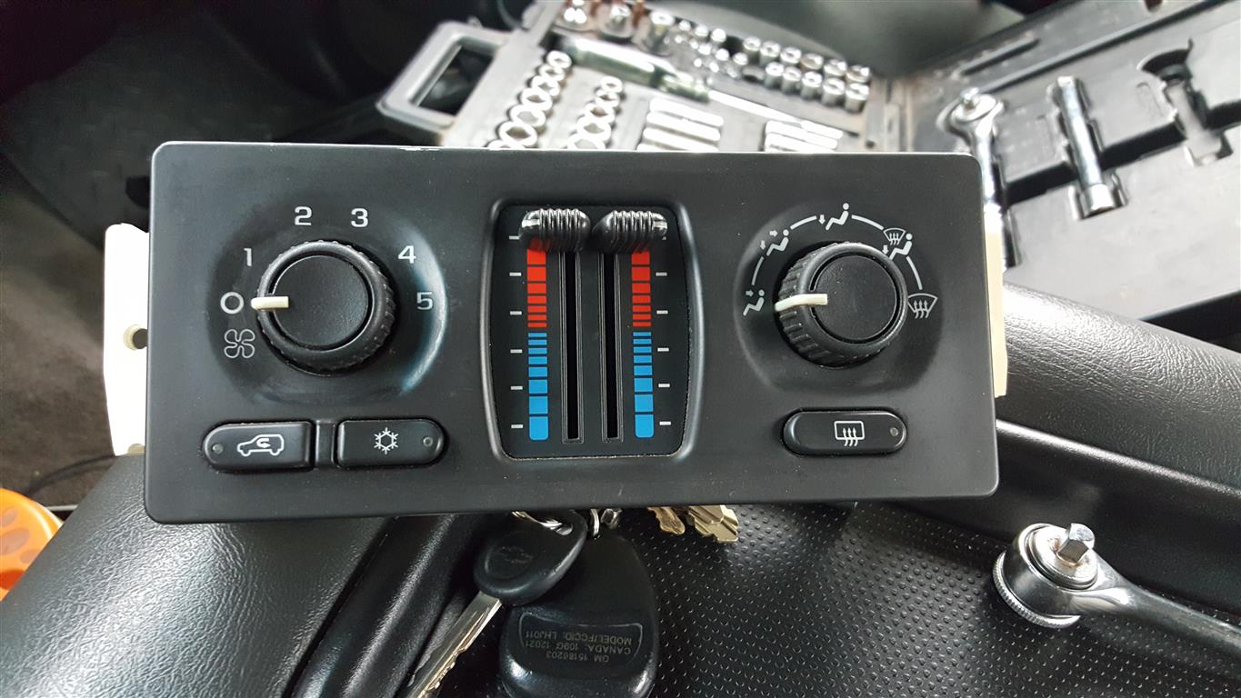

This past Saturday I did a LED and Stepper Motor swap on my 03 Silverado.
In the process I also changed out the bulbs in the climate control unit.

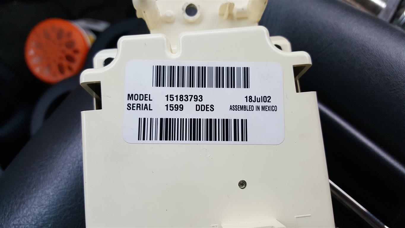

While the circuit board was out of the CC unit I decided to plug it in and make sure all of the bulbs worked before I buttoned everything back up.
I think.................No, make that I KNOW I plugged the harness in upside down and got hit with that distinct smell of burnt electronics for a moment. Unplugged the harness and flipped it around. All the bulbs were good and I put everything back together.
Now I have no control over the direction of air flow....if I turn the knob to any position it still only blows out the front vents only. The blower speed control is fine.
Could I have cooked the blend door actuator or just threw it out of sync ?

Update: No codes, pulled fuses, they are ok.
Another thing I noticed, the Recirc, A/C and Rear Defroster Buttons are not lit or functioning..
My money is on the unit itself being fried.
Could I have shorted out the blend door actuator ? Anyway of just testing that ?
Unit is trash bud..
That's exactly what I'm thinking
