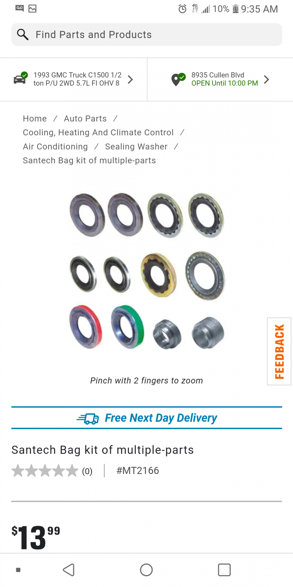

20200705_192735.thumb.jpg.b8aa8cec51a10126c431358296cb3869.jpg I'm New to this forum so Im hoping someone can help. I got a new compressor at advance  the carquest premium r134 for my 1993 gmc 1500 which was r12 before and after installing the suction and condenser hose to the rear I noticed that it wasn't sitting right because the new compressor has 1 of the holes without the same depth so the hose doesn't go in all the way flush .I'm I missing some kind of adapter or did they sell me the wrong compressor.they told me I can't get a refund even though it says it's a direct fit so I'm kind of lost as to what to do.i don't want to put freon because I think it's going to leak it out .I read on reviews that other people had the same problem but didn't specify how they made it work .thanks for any replies.
.I couldn't find what the kit was called but finally found it on Google and AutoZone sells it .I ended up leaving the thin washer on the side that was not flush and adding the black thicker washer on the side that went in flush to make it even with the 1 other side .I had to remove the compressor again because I didn't know the oil should go into back of compressor before installing .it had 2oz so I added 6oz or about 6 because a little bit spilled I hope it doesn't matter.i also put 2 oz left into the accumulator.i just got back from filling up with refrigerant and every came out good.i changed everything myself but did have setbacks with oriellys condenser not letting me stick the orifice tube all the way down but AutoZones spectra 1 came with and fit perfect.here is pictures of washer kit and the way it looks after installing
