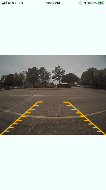

3.  Operation:  Set up was accomplished easily by following the directions that came with the camera.
Conclusion:  The camera is handy for close parking situations, looks decent and is a good addition to my truck.
