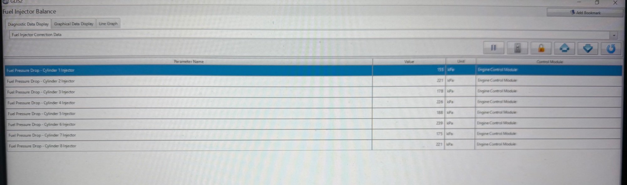

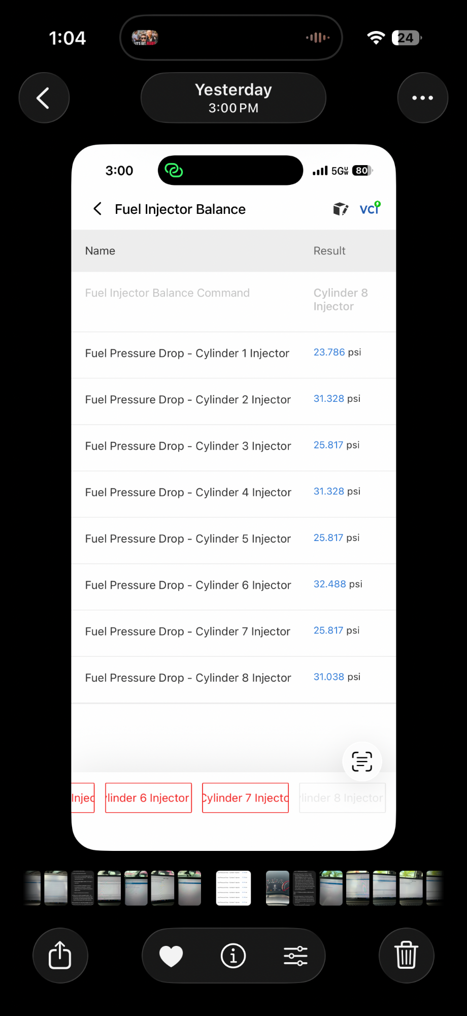

I ran an injector balance test just for the heck of it and it came back this. I’m confused.
I have gds2 and some other diag tools if anyone knows of anything I should test next.
