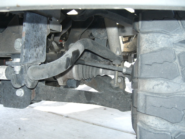

I have a 2002 Chevy 2500HD with the 8.1L engine.
I just put on 20 inch rims with 37inch tires.
When I turn the steering wheel all the way to the right or left, the inside of the tires rub on some sort of anti-sway bar. Not sure what you would call this bar.
I was wondering if there were any simple solutions to prevent the tires from rubbing.
If that is the only issue, try a 1/4" spacer. You can get them on ebay.
Oh, it is called a sway bar. Tires this size are normally mounted on wheels with 4.5" backspacing. You probably have more than this. Can you find out what width and offset you have?
A 1/4in thick spacer does not seem like it would give enough space to prevent the tire to sway bar rub.
Are you instead refering to a wheel adapter?
I do not have any information about the width and offset of the rims. I can give you the tire size though.
if it barely rubs then a spacer will help. No not an adapter.
If you want your turn radius back, you need to get correct backspacing.
Have I read this wrong...you have 37's on an unlifted truck?
I have 37in tires with a 6inch lift.
Thanks for information about the backspacing. I will look it up.
