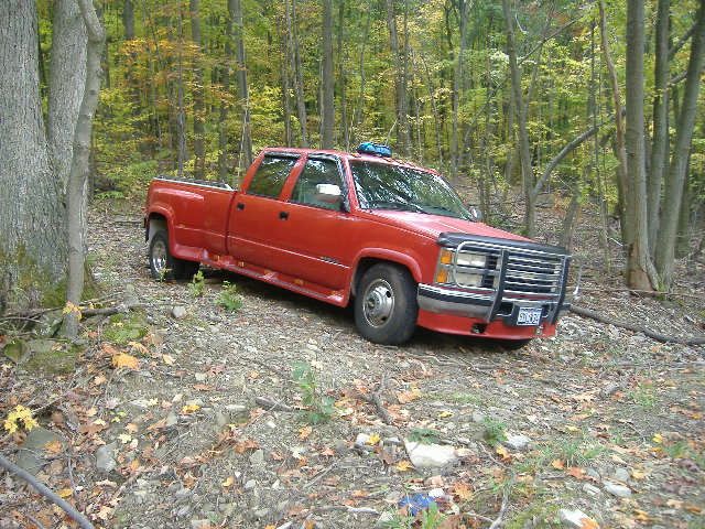

here is my problem i hope one or some of you can help me with i have a 93 6.5 turbo that is only getting 13 mpg and the turbo isnt realy sounding out the way it use to to the mater at hand i would realy like to find a way to get more mpg because at 4.49 pg its hard to drive and any sugestions as to what i can do would realy help and the turbo when i bought the truck the turbo sounded out but now its not wistling i guess you would say and i cant feel the power i took the air box off and placed my hand to the air intake and it has suction but it just doesnt sound right to me
