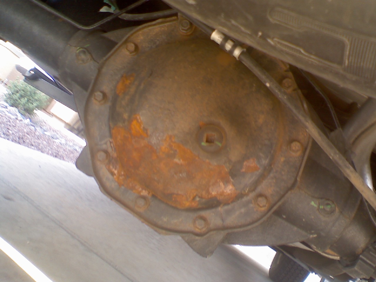

I was just wondering if anyone is familar with rear diff paint peeling, (noticed with less than 10,000 Miles) Is this a lousy paint job or is it getting too hot. All answers appreciated.
Thats why on every new truck I buy the first thing I do is put'em up on a lift at work and scuff-n-paint the axle housing with a nice coat of semi-gloss Black paint.
At least they put some paint on the truck ones,I remember the Camaro's & Caprice's/Impala's when they were new,back in the day,The rear-end housing wasn't painted at all,They were bare metal!
RedRock,I thought you where talking about the rear-end housing itself.....Now that I look at the picture you posted I see your talking about the rear-end housing "cover",I would take in to your dealer,since I assume its still under warranty,and have them either replace it with a new one,or sandblast your existing one and repaint it.
Whats going to happen is eventually that cover will rust to the point where rear-end fluid will seep through and leak,the metal on the covers is not very thick,I stock covers at the dealership for both the 7.5" and 8.5" truck rear-ends because of them rusting through,Especially the area in which I live (SW Pa.) where they use a lot of salt in the wintertime.
Also a new cover from GM will come bare metal,so make sure if they give you a new one its properly scuffed,primed & painted before they put it on your truck.
If you live in an area where they salt the roads alot, that might be part of your problem. Youll want to thoroughly wash under your truck every now and again. And by wash, i mean use a wand, not just drive through a touchless.
No salt here in AZ
I'd still get it replaced or repainted,Besides....I hate looking under a truck and seeing rust like that :P:crackup::lol::thumbs::D

so what works best on the frame wax for re coating....mar hyde works well on other projects ive done. Do ya think it will hurt any to spray some spots....as for the diff cover...por 15 is what i'll be using. Mine has a little rust on her. Surprised with the salt here in NE PA
