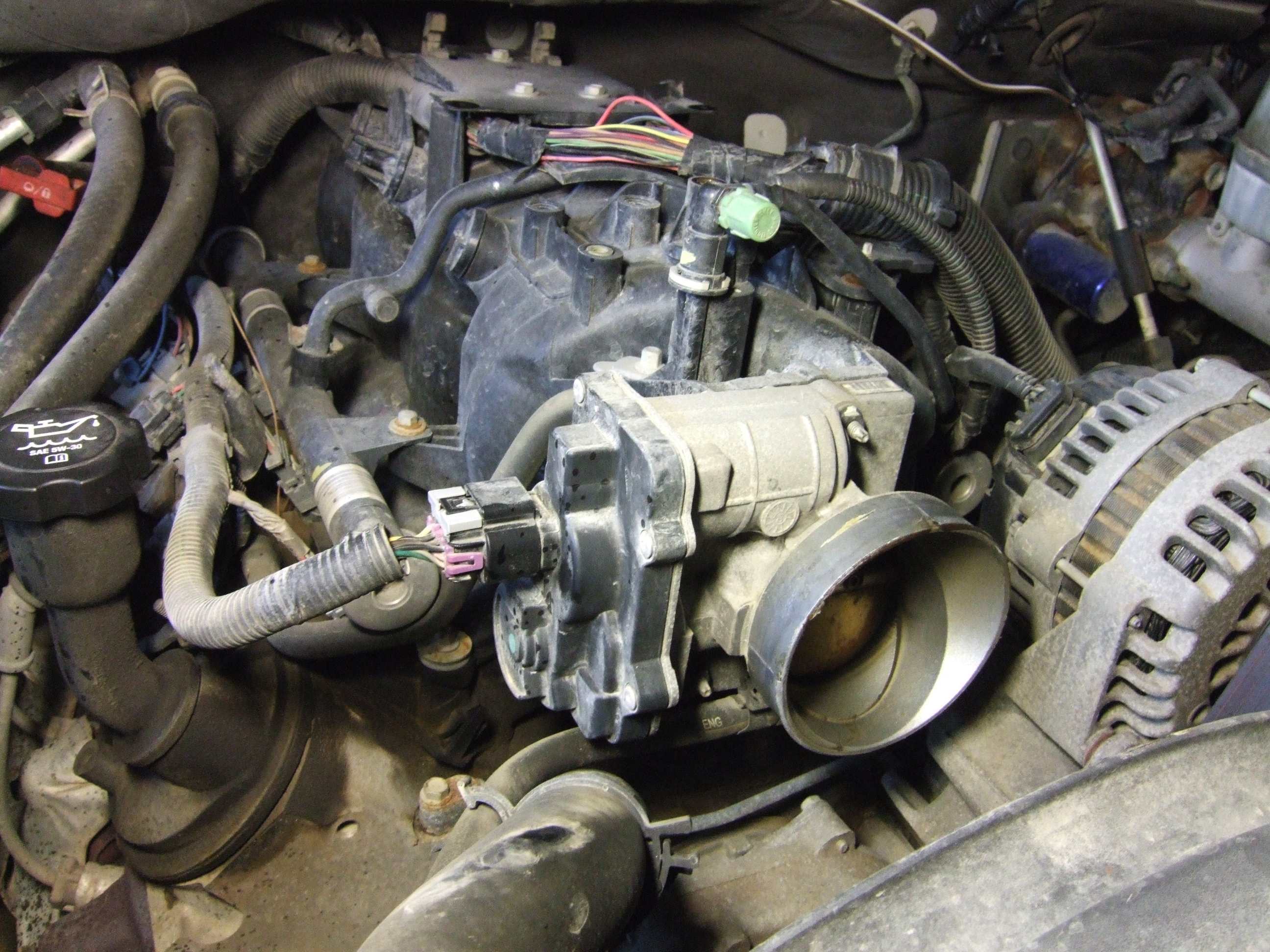

I hooked up a throttle body (TB) to the engine's wiring to see it operate/ respond to accelerator pedal (AP) input.
What I noticed is that the TB's baffle would flutter as it repositioned to AP input.

Never ran it without the air tube. The flutter was only visible with another TB temporarily plugged into the wire loom, while the electrical was just energized and engine not running. This was a static test for visual benefit.
