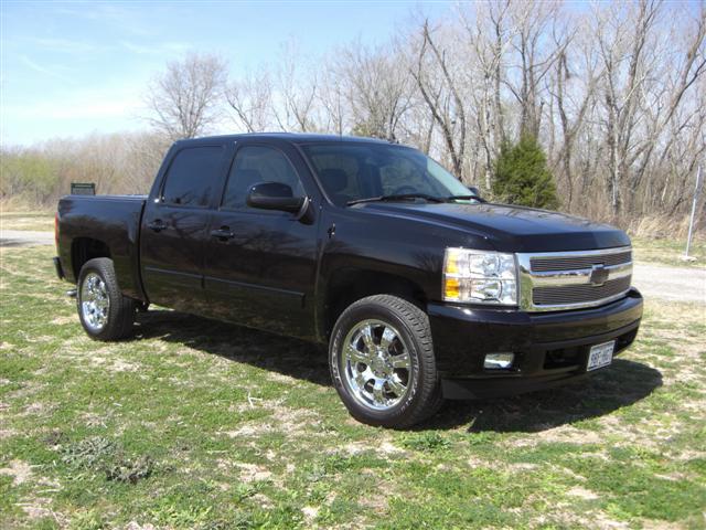

I'm trying to figure out if I can use my factory D20 Dub chrome wheels with the Rancho 4" lift. I see people running 17" factory wheels with the lift. I hate to part with these wheels. I like them and they are a factory upgrade from GM.
Any assistance would be greatly appreciated.

I don't think you will have an issue, I am getting ready to put a leveling kit on my rig next week (not near as tall as yours) and am going to put 275/75/18 33.2/10.84 on my stockers. Lots of guys use their factory wheels so I don't think you'll have any issue. Here is a link to the calculator I have been using. Just scroll all the way down and input you stock size and size you are considering. Here's the link http://www.readylift.com/t-tire-calculator.aspx . Also, a buddy of mine has a leveling kit, 2 inch blocks in the back and runs 275/65/20's (34.07x10.83) without an issue. I noticed your in Dallas, so am I, I have been debating on which size to go with and called Discount Tire on Lemmon, and they are ordering a set of both sizes I'm considering and are going to test fit them. If all else fails just give them a call and ask for a test fitment. Hope this helped!
