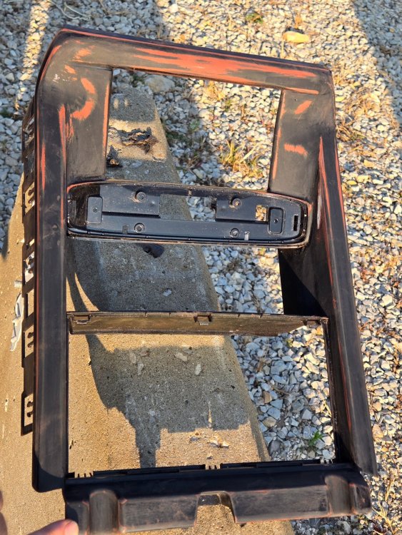

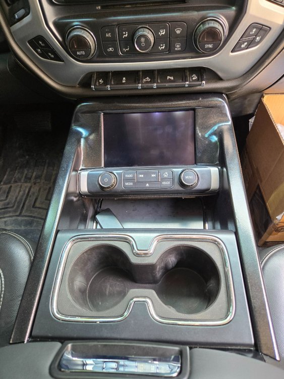

  12. No I didn't make a topic on it. It's a project that is slower then a cat with rigor mortis. I'm working on installing a ipad in place of the radio in the dash because I'm not a fan of the tesla style radios. I also don't like the idea of having to remove the ipad to change settings on the radio screen. My plan is to have the radio in the center console, and I will use it to display the music information and use the full screen of the ipad for navigation. Thus far I have completed the radio relocation pieces for both my 14 and 18 Sierra's and will start working on the Ipad dash pieces soon. hhere it is in the truck. This is the one I did for the 14.

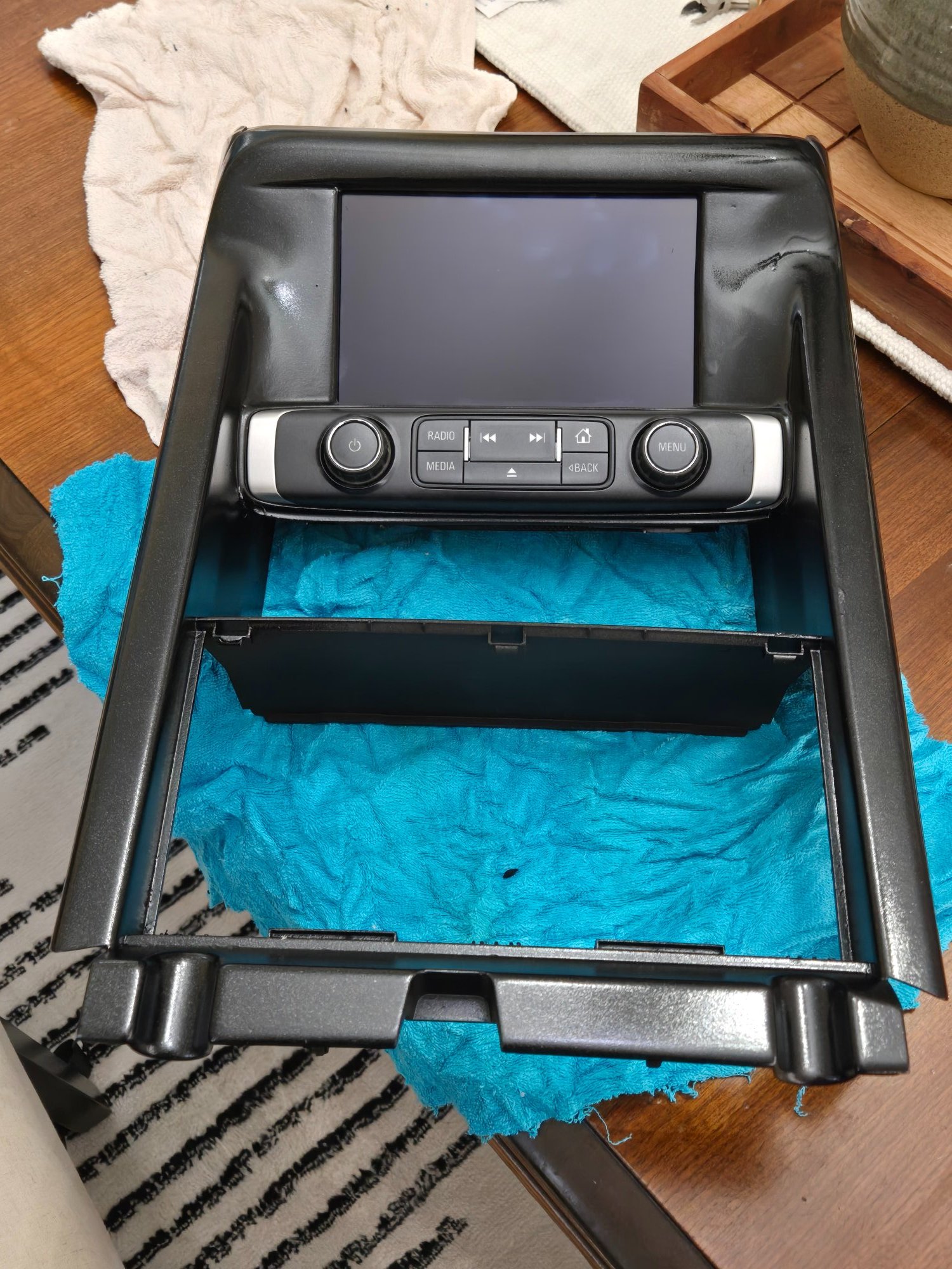

  13. Finished painting the radio piece. It's ready for install.

  15. Finished intake cover and made progress on the radio relocation piece.
