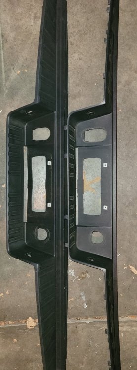

2500 rear bumper on a 1500
superdave160 replied to superdave160's topic in Modifications & Accessories
Yes, swapping the mounting brackets and the step pad effectively converts the 2500 bumper to a 1500 bumper. The chrome bumper is currently installed on my Silverado 1500. -
I couldn't get the pictures to attach to the original post. The picture attached to this post shows the two mounting brackets. The one on the left is the 2500. The one on the right is the 1500. Also attached is a picture showing the differences in the thickness of the top lip of the step pads. The one on the left is the 2500.
