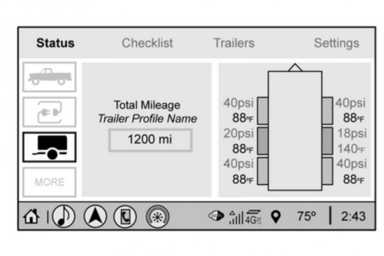

  6. I have a 2020 Silverado with the Advanced Trailering Package option. After the trailer light cable is connected and truck started, trailer tire pressure and temperature will automatically display in the infotainment system Trailering app under the Status tab > Trailer icon. See attached pic from owners manual in myChevrolet app on my phone. Occasionally, I have to pull the trailer a short distance before the truck sensor picks up the trailer tire pressure / temp. Of note, this option on my Silverado came with four TPMS sensors for a trailer. I had to pay dealership to install the sensors on the trailer tire rims. I then manually programmed the trailer tire position through the Trailering app and whenever I rotate the tires.
