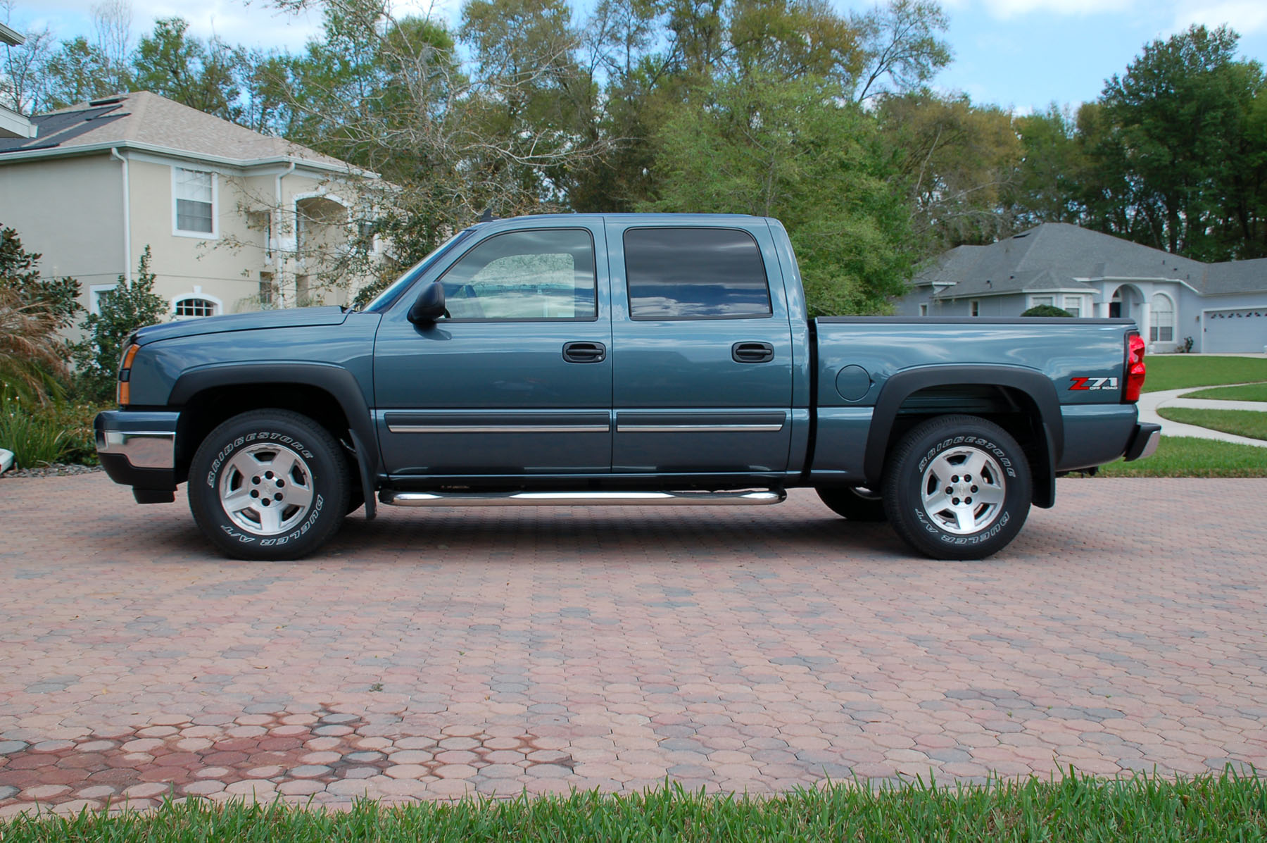

Just for an idea, here is my truck before the new tires and torsion bar cranking. This picture is when the truck was 5 months old and the only change was the chrome steps. You can see that the change is minimal.
