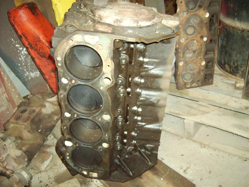

Rebuild Kit For 427 Tall Deck
Headers and a better intake would definitely help. The usual rebuild of bearings, rings, pistons....maybe a small overbore to straighten the cylinders out due to any core shift. High Volume oil pump would be a plus as well.
What or where would you recommend for a rebuild kit for a 427 truck engine/tall deck?
Stroker kit( at least 500 cid), aftermarket heads, mild roller cam and aftermarket efi. Make enough torque to probably ruin whatever tranny is behind it in your 3 ton ( ours used to have a Clarke, but it was a 5 speed with 2 speed rear end). You asked, lol......
