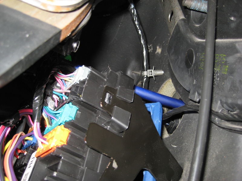

Theres some metal above/behind the junction block that easy to drill through and use a heavy duty grommet. The foam insulation even has a precut circle there, i think for manual trucks. You need to unbolt the junction block but it keep the wires out of the way and with the sealing grommets stay water tight although I've never seen a problem running it through a slit in the main harness grommet, thats how we did it at a shop I worked at, I just wanted a super clean install for my truck.
