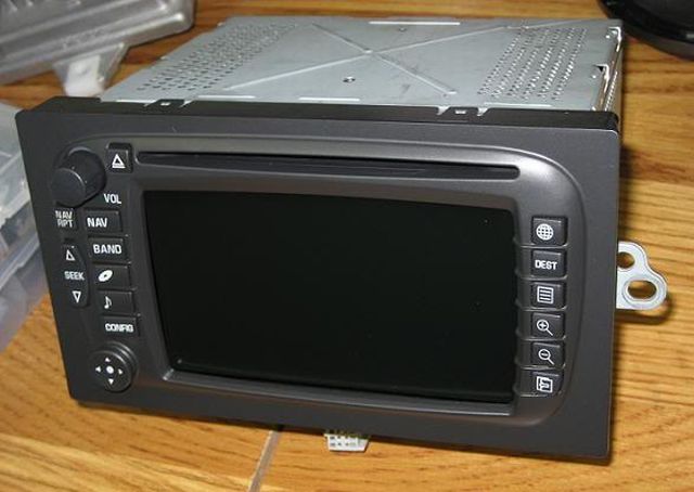

I have little problem with my hummer H2 Navi ???????
In my display stand theftlock Activated !!!!!!!!!!!!!!!!!
And i have no Radiocode for this Navigation
What can I do ???????
And sorry for english, I´m from germany
Here's a couple things to try, I don't know if any of them will work, but it's worth a try. Also you could call your dealer and see what they say, they should be able to do it very easily
"** Theftlock Bypass
1. Press and hold presets 2 & 3 for about 10 seconds until the first 3 digits of the display code are displayed.
2. Write the numbers down.
3. Press the AM/FM button, write down the next 3 numbers.
4. Call 1-800-537-5140, when asked, enter 620529, press the # button and enter the 6 digit code from the radio, you will get an unlock code, write it down.
5. Go back to the car, press the HR button and set the first 2 numbers, then press minute button and set the next two last numbers, press AM/FM button, SEC should be displayed, turn on radio.
To remove customers code, repeat step 5. you should see --- on radio face, the code is now out of the radio.
EDIT: Updated with new dealer code. FWIW, the old code was 202107"
Here's another site that looks like it would work
I don´t now what are presets 2 & 3 is, my Navigationsytem have no number buttons
can anybody explain ?
Ok, well I found to make sure the radio is compatible with your hummer, and will function properly.
To do this, you will nee to put the keys in the ignition, and turn it to the accessory position, and then disconnect the battery for 3 to 5 seconds, (leave the keys in the ignition while unhooking the battery).
After reconnecting the battery, the radio should function normally until the key is removed from the ignition.
However, this is only a temporary solution. I will see if there is a way to permanently unlock it without Tech 2 at the dealer, but I do not think it can be done
I never get into the radio unlock issues/codes at the dealership (I leave that to the techs.) but I'm pretty sure your going to need a Tech2.
